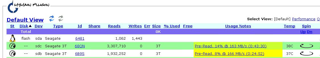

I attached a screenshot of my unmenu-mymain screen after restarting the preclear on two. Should I let these go then start the third, or start it now?
Unless you have specified the amount of memory being used by preclear I wouldn't run 3 3TB drives at once.
I did not. So I will not. Thanks for the advice and everyone's help and advice.
