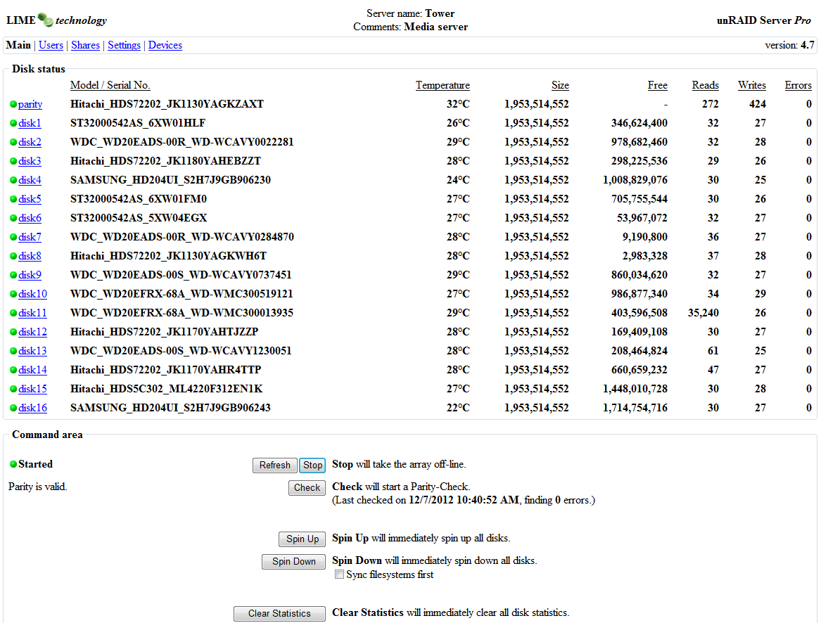

I'm a long time UNRAID user, but a linux rookie, so I need your help.  I have a stable server running version 4.7 and I can no longer write to one disk.
General info:
Parity - 2 TB Hitachi
Data disks - 16 x 2TB (mix of Hitachi, WD, Seagate, & Samsung)

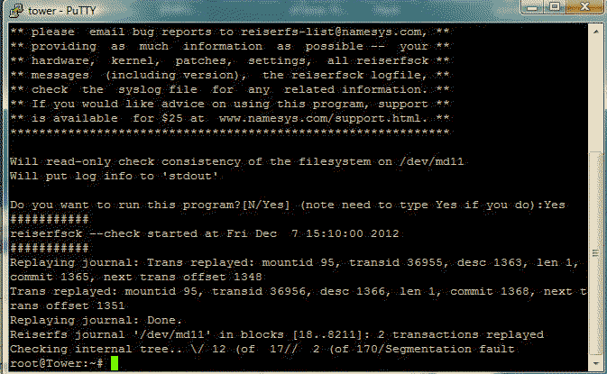

3)  Ran reiserfsck --check /dev/md11  - no change

I have stopped adding anything to this server until I can get this fixed, because, I'm guessing that I'm not really parity protected if it can't write to Disk 11.

The reiserfsck is failing with a segmentation violation. (it is attempting to use memory it does not own)
Step 1.  Perform a memory check on the server.  If memory is working properly, then it is a file-system fault that is causing the reiserfsck program to fail to complete.

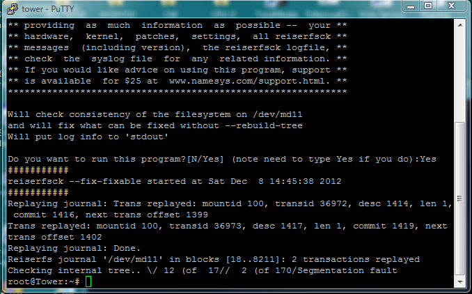

Step 2.  Try using
reiserfsck --fix-fixable /dev/md11

I ran Memtest over night (17+ hours) with no errors.  Then I tried reiserfsck --fix-fixable /dev/md11, then rebooted and still can not write to disk 11.  I have attached the results of reiserfsck and a syslog after reiserfsck.
