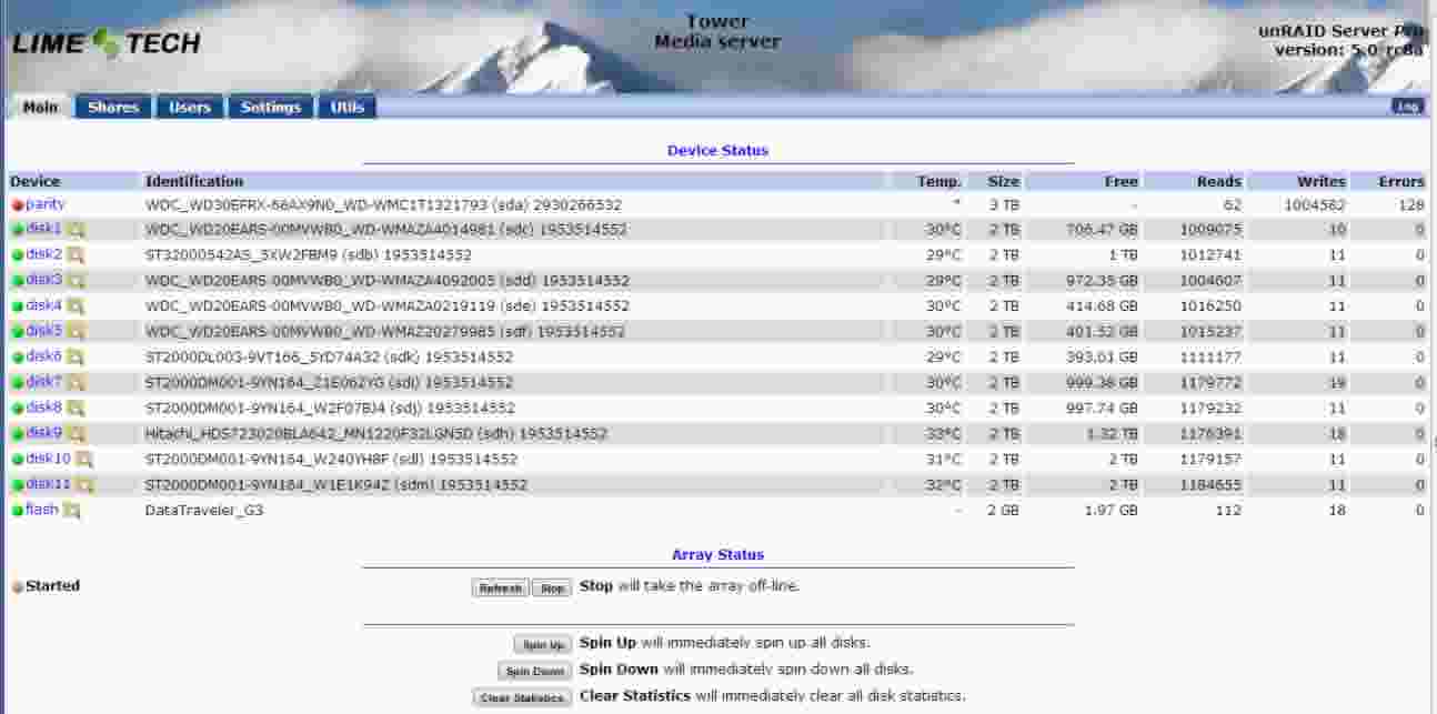

I rebooted and it did not detect  my parity drive or drive 2. I powered down, secured all cables rebooted and all was fine. I to sync parity again and I got errors again. See picture.
I am thinking of taking the 3TB drive out of another computer and trying to sync parity. Is that a reasonable next step? The 3TB drive in my other computer is not as "good" as the WD Red though.

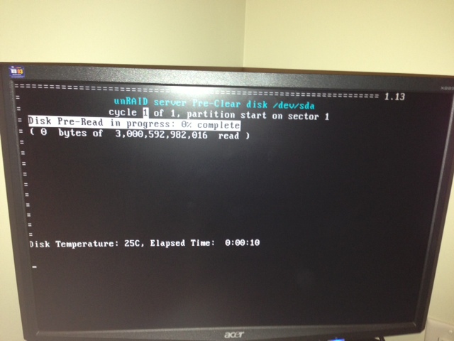

I am running the utility. Is it normal to have nothing change in 45 minutes?
Still says 0% 0 bytes of 3,000,592,982,016 read, see photo.
nope, that's not normal.
you said, the disk is failing the smart test, which would point to a faulty disk. post the smart results...
