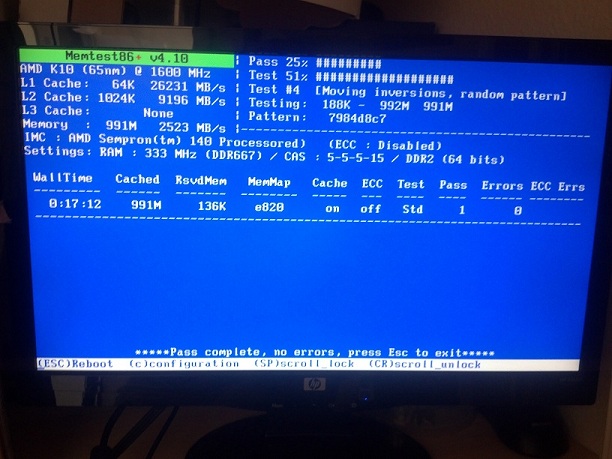

If you haven't had a problem for years though, first I would try memtest to make sure your ram is okay.

OK, I will do a memtest and post the result.

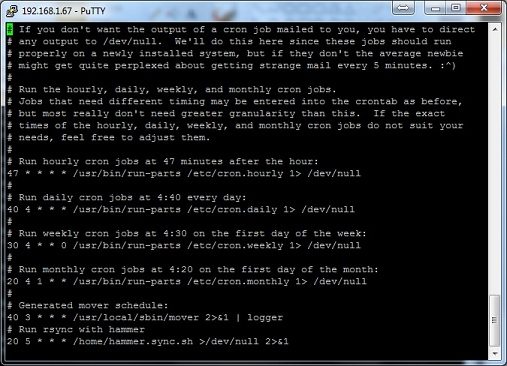

I dig into the rsync and realized I had setup rsync crontab job everyday at 5:20AM.  I will get rid of this rsync and hope this will clear up my issue.  Once again, thank you for your help.  I love this forum  8)
P.S. Did the memtest and the 1st pass had no issue.
