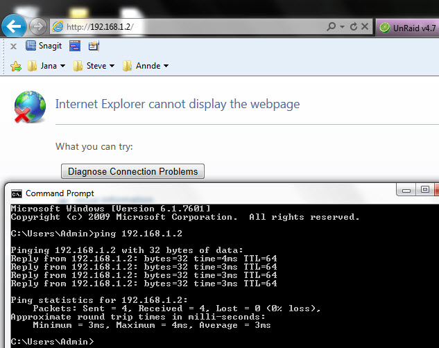

The server has the following address:
Dec 16 15:50:32 Tower ifplugd(eth0)[1279]: client: dhcpcd: your IP address = 192.168.1.2
That is the address I am trying to access.  See the attachment as I am able to ping 192.168.1.2 however, I can't access the WebGUI.

Is there any firewall or security software running on the PC?
Kaspersky Anti virius application.  The server was working fine before I had to swap out the hard drive failure.
Based on reading other similar post is it possible that I need to re-start the emhttp?
I'd try disabling or removing the anti-virus software. AV software often blocks web access to unRAID.
I have disabled the anti virus and turned off the firewall.  No dice still can't access the Web GUI (Tower Main) page.
Can the other machines access the main page? Have you tried other browsers?
