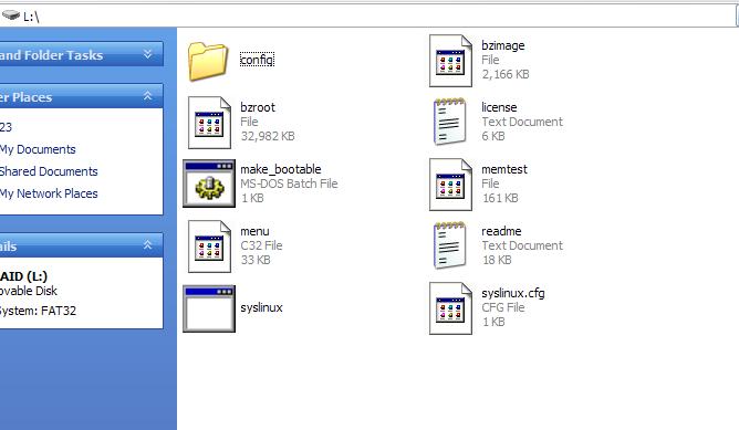

Hey guys, so i have been reading the Wiki to boot up my unRaid server, I get to this point where i have to shut the server off, then move my USB drive to another PC and find the mcedit file...etc

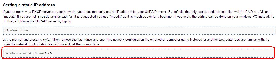

I added screens of my USB drive and where I'm stuck, basically i can't find the mcedit on the USB.
Plug the flash into your PC and navigate to the 'config' folder.  Edit the file to look something like this:
USE_DHCP=no
IPADDR=192.168.1.10                  <--- put your desired IP address instead
NETMASK=255.255.255.0              <---- your desired subnet mask
GATEWAY=192.168.1.1                <---- your desired gateway address
DHCP_KEEPRESOLV=no
DNS_SERVER1=192.168.1.1        <---- your desired dns server
DNS_SERVER2=
DNS_SERVER3=
Will do, now all i did was DL the unRaid 5 FW onto the drive (per wiki) but there was a highly recommended download as well , un something ?
Do you normally have to enter IP address information for your computers? If not, you probably have DHCP & do not need to edit the file.
If you do normally have to enter IP address information, you do not have to use mcedit. mcedit is not a file... it is a text editor. If you are more comfortable using Windows, Notepad++ is a good program to edit text files.
The file you will be editing (if you need to set a specific IP for this computer) is in the config directory & the file is named network.cfg
no, i don't believe i have ever set an ip address manually, do i still have to config the file like it said in Wiki ? (its one of the attachments i added) if yes, i cant find the location its asking about and should i try limetech's way ?
The first line of the attachment says "If you do not have a DHCP server on your network, you must manually edit the file". Most home routers have DHCP in them by default. I don't think you will need to manually edit the network.cfg file. If you have never manually setup your IP address (or had someone do it for you), you have DHCP.

I never edited the network.cfg. I just booted, went to a computer on the network, went to http://tower. Then set my static IP from the webgui.
