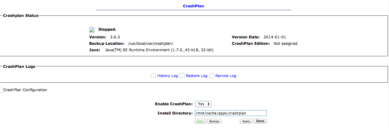

New Crashplan 3.6.3 merged with the gui plugin
best way to install is
remove previous crashplan plg and crashplan gui plg from /boot/config/plugins
add the new Crashplan.3.6.3.plg to /boot/config/plugins (rename the download from Crashplan.3.6.3.plg.txt to Crashplan.3.6.3.plg)
rename your backup in your install dir from crashplan_backup.tgz to crashplan_backup.old
rename cp_bin folder to CP_bin.old
installplg /boot/config/plugins/Crashplan.3.6.3.plg
this will take some time as he will download the new crashplan package
go to the webpage in your GUI
check the installdir if it is correct
enable the plugin
start the plugin
BE AWARE he will download a new Java version which can take a long time to download
look into /boot/temp and you will see the java version .... when you refresh you will see it grow slowly in size ... i think it should become about 32mb
when the /boot/temp dir dissapears then it is completely installed
you should have a window like the one attached
if you want you can delete the old backup and the old cp_bin folder

Hey lannister did you see my reply to myself?
Also with the new plugin there should only be one GUI tab like in the picture you listed (they combined them). I'll try to help troubleshoot.
Where are you stuck? Are you able to tunnel using ssh? or can you not connect? Does it not start?

installed the plugin from scratch (no previous install) using the "Crashplan.3.6.3.plg" file.
installed it onto my cache drive, it appeared to install java (saw the temp file come and go).
now looking at the plugin in Unraid 5.0.5, it says "stopped" and doesn't switch to "running" at all.
trying to SSH in, no problem, using openSSH on unraid via a plugin.
when running Crashplan from the remote MAC via SSL, obviously get a channel 3: connect failed error because the crashplan plugin isn't working.
any thoughts? screenshot attached.
thank you in advance!
