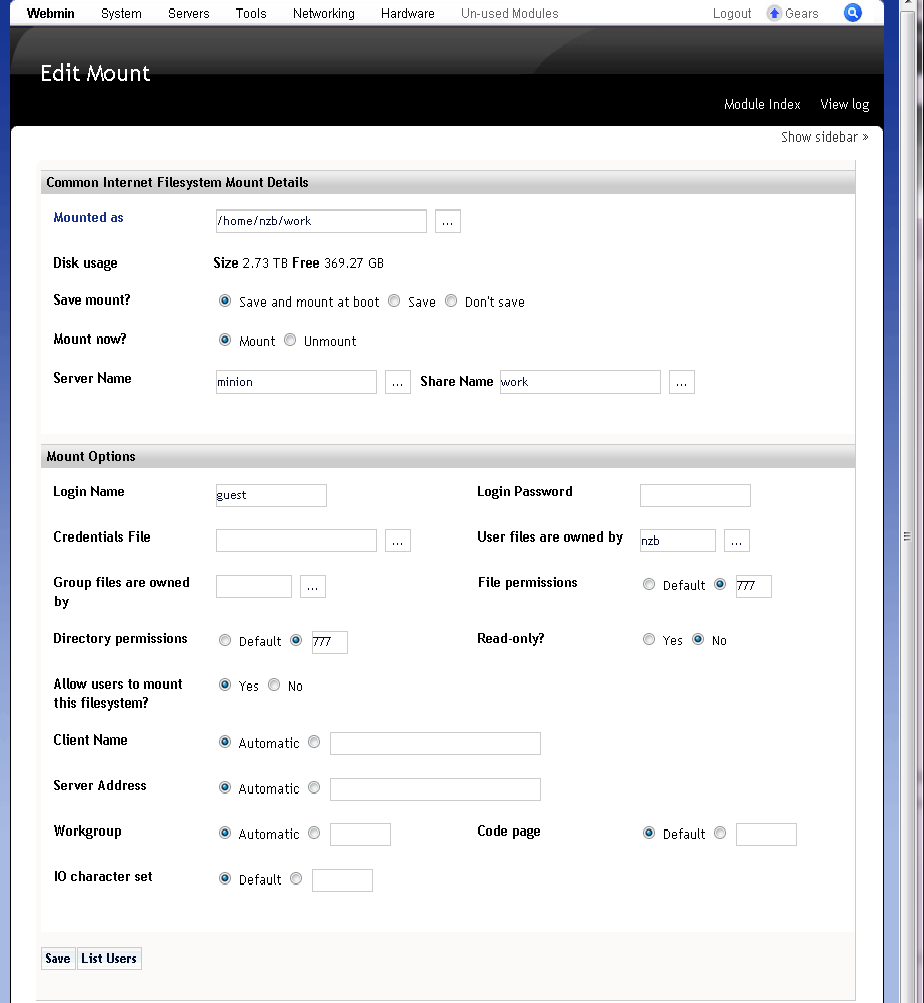

I've not ever really done much with mount points or permissions. I'm hitting a snag mounting a share on my unRAID box from a Linux appliance and would appreciate some help. Background is this - there's a guy who makes a very complete and nice looking Linux appliance for SAB/Sick/Couch/Headphones. I have fired this up and it really looks very nice! I would like to move to this so I can dump a Win7 VM I'm running that's not super stable and a bit of a pig.
The issue is that while I can mount directories outside of the VM I cannot write to those directories. If I setup the VM to download something it needs to be stored outside of the VM and interact with my unRAID shares. I have created a mount point that points to the unRAID server share and can see it, but I cannot write to it. The process trying to do this has limited rights in the VM and unRAID being mounted using "guest" as I have no accounts setup on my server and anything else wanted a password. I'm being asked to chown or chmod the directories however this doesn't seem to be working and I believe it's because the directories I'm trying to effect are actually ON the unRAID server. I am also concerned that if I were successful I would run into permissions issues on my unRAID shares but I'm not sure. The whole thread with screenshots is posted here -> http://aceshome.com/forums/index.php?topic=20.0

Well, as it stands now I've got a mount created, I'm trying various permissions etc. The user on the client side is named nzb and the user has a "preshared" password hash so I don't know the actual password. I have created the mount both through a web shell and via the Webmin interface. If you look at the linked thread you can see some of the pains I've gone thru trying different things.

Edit: Okay solved I THINK. Webmin was making some fairly whacky looking mount entries in fstab. I mimicked an entry that had worked for someone else and it's working. I think this isn't an unRAID issue but a whacky Webmin creating bad mounts. <sigh>
Lovely, while it's true that things now process properly I'm now getting files created with the username of the account used to mount the damned share. :o From a Windows box I'm unable to delete, rename, or do anything very useful with the files other than read them. Argh!!
