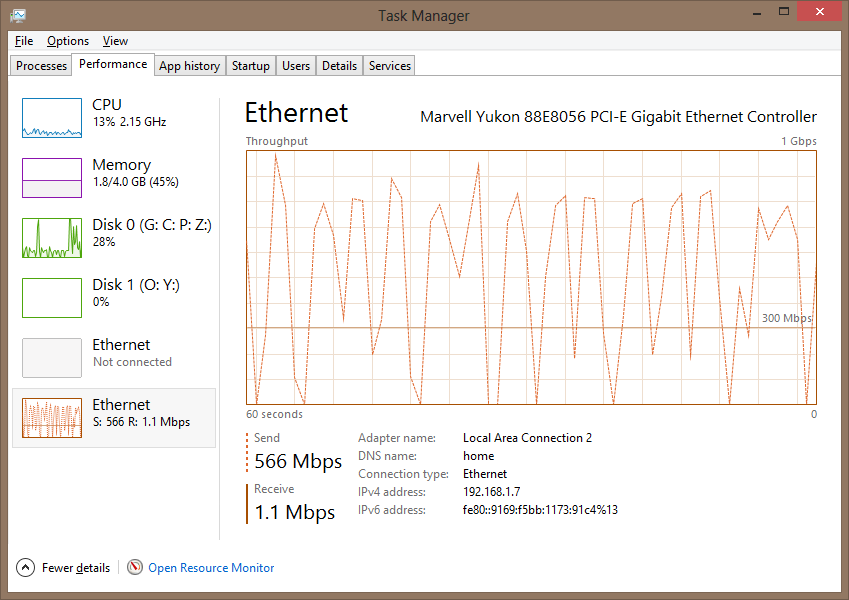

Transfers to the unraid server from my windows computer fluctuate.. dropping to 0Mpbs, and then back up again.  CPU usage of shfs and smbd also skyrockets to near 100% at the same time. (CPU usage also fluctuates.. I'm assuming shfs/smbd may be causing the problem)

The files I was transferring were 4-5GB+ each. And they were queued and transferring one at a time in a single explorer copy dialogue.  (and like I mentioned before, I tested another large transfer from an Ubuntu installation, with the exact same fluctuating result). I'm not sure the exact timing of it.. But t seemed like every 5-10 seconds, transfer speed would drop to 0 or close to it.

I tested an N36L with LAN Speed Test (Lite) software. I see similar behavior but it never drops to zero. However, throughput does not seem to be effected adversely. I get about 36MBps writes and 68MBps reads. I think it may be due to the caching on the server filling the buffers which causes TCP to back-off. Once the server disk buffers are emptied, TCP is able to ramp up and until the buffers are full again. What is the overall write speed?
Thanks for the reply.  I think I was getting averaged write speed somewhere around 25-30MBps.  Not awful..  but not great.  I could actually live with that (though faster is always better!)  if things seemed normal otherwise.. but the fluctuation combined with high cpu makes me wonder how trustworthy things are as they are right now.
