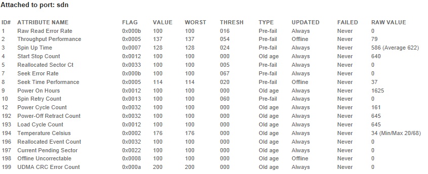

Also the SMART report you posted shows that that disk has reached a temp of 68 degrees. Not good. The disk might be toast (baked), no pun intended.
Yes that 68 was because the 2 Fans for the hdd's not working for a few minutes.
Do you still trust that disk? I think I wouldn't. Maybe RMA?
