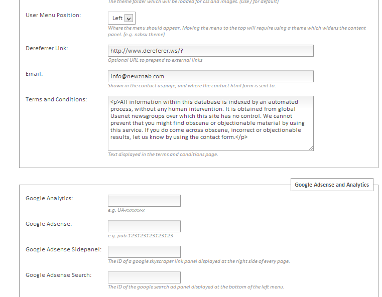

I received the ID in my email from them. The problem is the field where you would put the ID is not there.

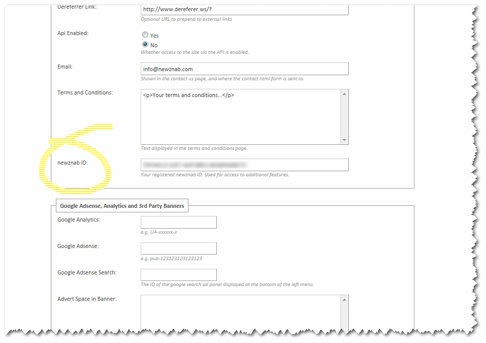

Please see the attached pictures:
I believe the reason the ID field is missing is because I have not upgraded to newznab+ which I can't seem to figure out how to do.
Thanks
That's odd. I'm not using nn on Unraid. When I get home ill look where it goes in database. You could browse the db to look too. Should be a field there.

That's the thing, it's not doing that, when I log in, I don't have the newznab+ logo.
