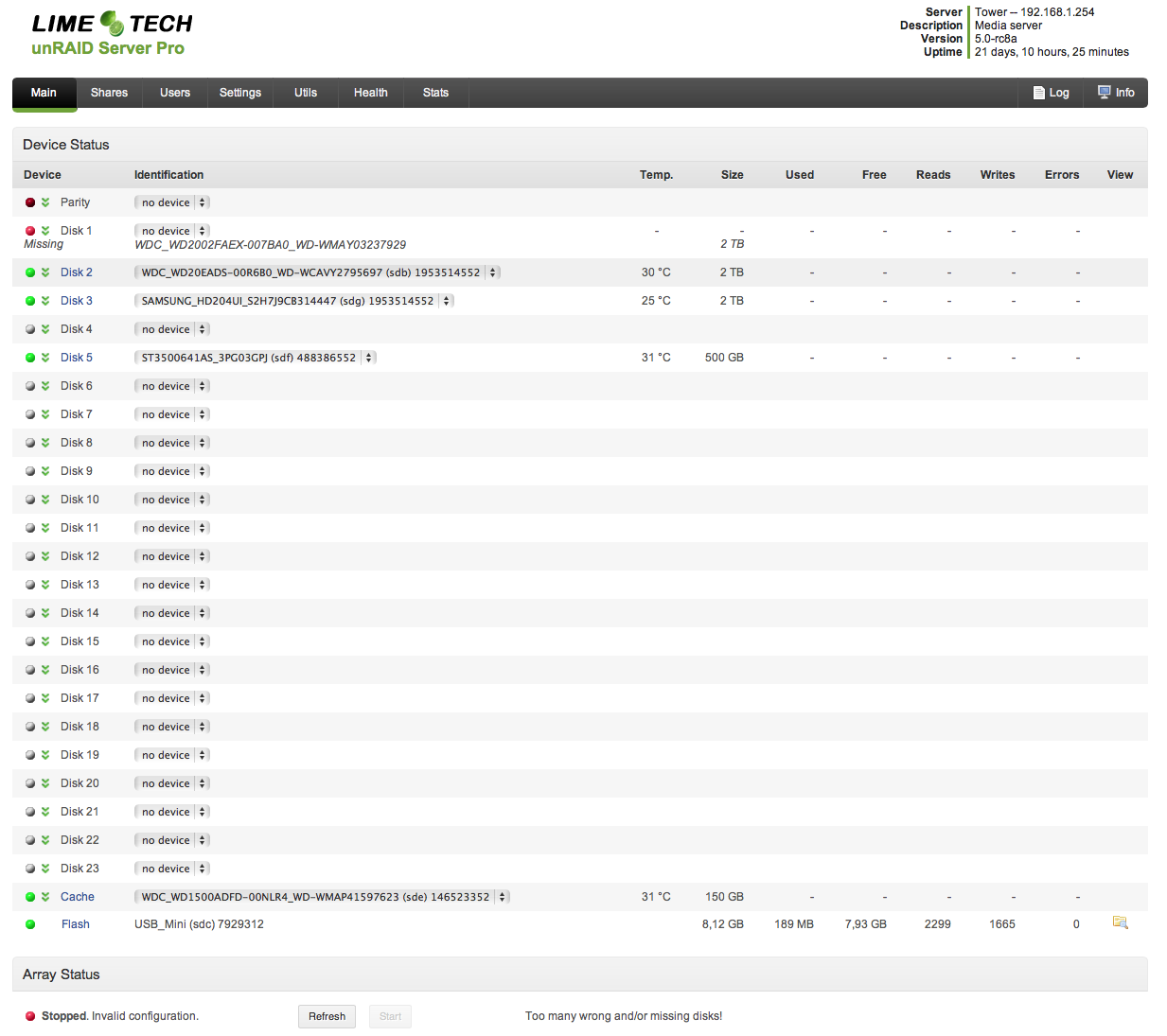

Would need some help. Woke up this morning, not with a hangover, but with issues on my unRaid server. At 00:30, the parity sync started and apparently there were some issues. I saw the Parity disk with a red ball this morning (Parity had 700 or so Write errors). All other disks had a green ball. I stopped the array and to my horror I'm seeing now not only the Parity disk with a red ball but also one of the array disks. Syslog and screenshot attached.
Is there a way I can still recover from this?
syslog : https://dl.dropbox.com/u/3121169/syslog.zip
screenshot: https://dl.dropbox.com/u/3121169/unraid.png
Since they both say "no device", odds are it is power related, or disk controller related, or one disk blocking the other on the same controller.
Before doing anything, make a copy of your "config" folder.  You can regroup more easily with it in case you need to revert to a known state.
Since a "single" write error will make a drive go red, I'd power down completely, then try un-plugging and re-seating anything common with those two drives first and rebooting.
It might be a power splitter, or a back-plane...
Odds of two disks both going bad at the exact same time is pretty slim.
Right now, both are marked in the syslog as either  "missing" or "removed"
You've got a lot of drives... is your power supply up to the task?  (what exact make/model are you using?)
Joe L.

For the Parity disk however, I think the RAW_VALUE numbers are good but there are read errors (did the short smart test 3 times, 3 times read error) :
root@Tower:~# smartctl -a -d ata /dev/sdd

Is this a bad thing or should I just write & check parity again?

The parity disk needs to be totally rewritten. Use the New Config button on the Utils tab. After the rebuild the Current_Pending_Sector RAW_VALUE should be zero. The Current_Pending_Sector RAW_VALUE must be zero.
I did a preclear of the parity disk. After that, the smart report is without errors. Result of preclear :
1 sector was pending re-allocation before the start of the preclear.
1 sector was pending re-allocation after pre-read in cycle 1 of 1.
0 sectors were pending re-allocation after zero of disk in cycle 1 of 1.
0 sectors are pending re-allocation at the end of the preclear,
    a change of -1 in the number of sectors pending re-allocation.
0 sectors had been re-allocated before the start of the preclear.
0 sectors are re-allocated at the end of the preclear,
    the number of sectors re-allocated did not change.
Then I used the New Config util and synced parity again. Did a parity check afterwards. All is working fine now. I ordered a Corsair AX760 PSU, it will arrive in some days.
Thanks everybody for the help on this.
