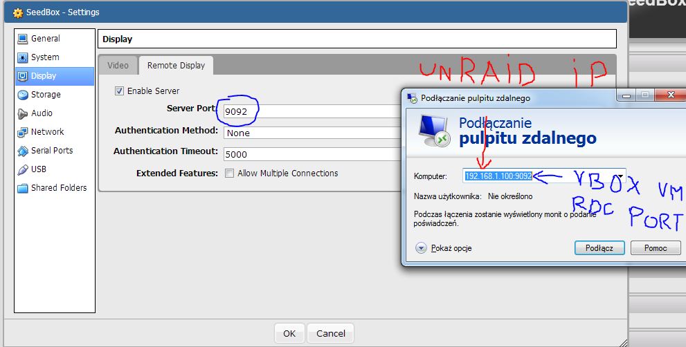

In order to be able to log into phpvirtualbox, I had to run
VBoxManage setproperty websrvauthlibrary default
After that, everything started working perfectly. I tried a USB stick. I had to set up a USB filter for it to work, but it works.
Edit: Seems that phpvirtualbox won't mount an ISO to a guest.
vboxmanage storageattach SeedBox --storagectl "IDE Controller" --port 1 --device 0 --type dvddrive --medium /mnt/user/DL/debian-wheezy-DI-b4-amd64-netinst.iso
That works. Not a huge deal.

Hi  :-[
Now I feel a bit stupid, but when I have created a machine and connects my slackware iso file to it, and then start the machine, it boots up and in preview window I see that it booted Ok, I can see a prompt, but how do I access this machine from a web page?
Is it my IP for tower plus a port number? Or is it a setting in PhpVirtualBox that I missed?
//Peter
Hi  :-[
//Peter
via the phpVirtualBox interface you can set an RCP port and access it via your server IP:port.
Hi  :-[
//Peter
Go to your Virtual Machnie settings -> Display -> Remote Display tab -> Enable Server
Choose appropriate port, authentication method etc. (chapter 7 "Remote virtual machines" from VirtualBox manual will clarify everything), then e.g. on Windows 7 look for Remote Desktop Connection programme and type [your.unRAID.IP.address]:[VMPortNumber] (look at the attached screenshot) and press Connect.
