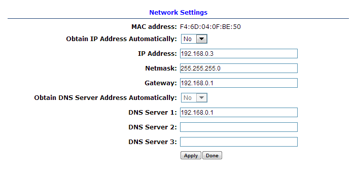

Attached are my network settings. Would a change to these require a reboot? It disabled then reenabled SMB when I clicked apply. Haven't rebooted (preclearing a drive atm) but still no dice :(
Change both No selections to Yes and click Apply.
Still not able to download plugins or send e-mail with both set to Yes :(
