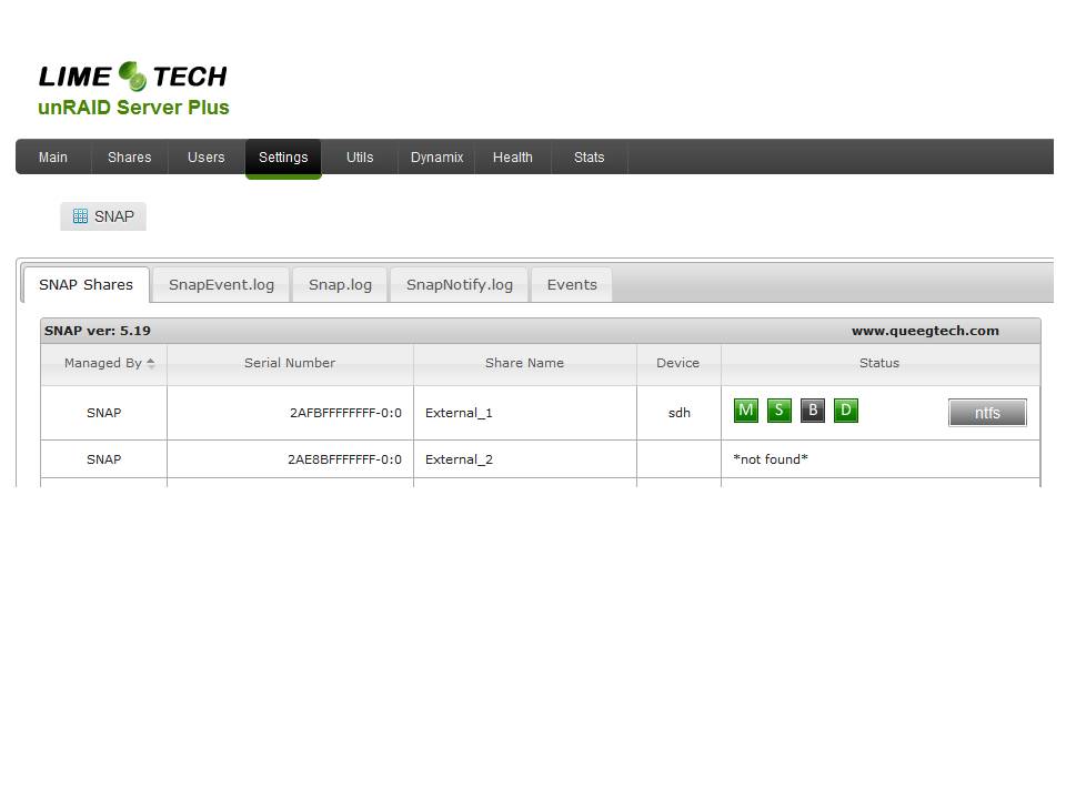

It is mounted because the 'M' icon is highlighted in SNAP.
I sued the GUI in Dynamix to name each of the drives i have and want to use. When i put them into the external dock they get mounted and shared without a problem. I have tried writing to them etc just to prove they work and all seems good, they are shared and available just like any other share so that part is working fine, its just the automation after its mounted that seems to be eluding me.

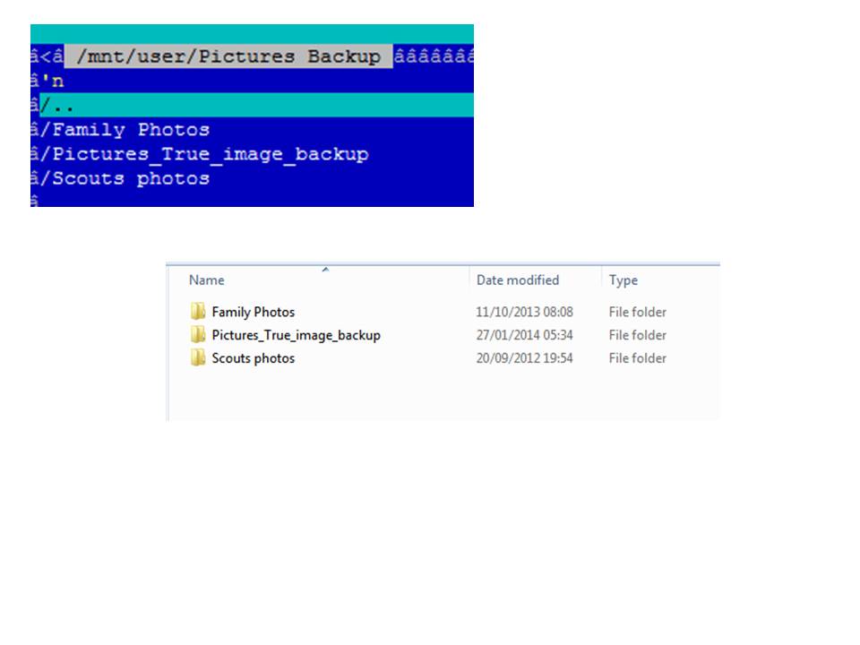

rsync error: some files/attrs were not transferred (see previous errors) (code 23) at main.c(1042) [sender=3.0.7]
rsync: change_dir "/mnt/user/Pictures_Backup/Scouts_photos" failed: No such file or directory (2)
rsync: change_dir "/mnt/user/Pictures_Backup/Family_Photos" failed: No such file or directory (2)
Running hotPlugAfterShareEvent.sh
devtype: part
HOTPLUG(s): usb-VB0250EA_VER_2AFBFFFFFFFF-0:0
Is it ok to add in additional empty lines to make it easier to read or for now is it better i do the minimum formatting so as to not make any more small errors !
Looks to me like the folders are not being created and so the rsync command cannot be completed - but i could be a mile off !
And the code looks like
case $SHARENAME in
'External')
LOGFILE=/var/log/External
PROG_NAME=External
logger Started -t$PROG_NAME
echo "Started" > $LOGFILE
if [ ! -d $MOUNTPOINT/flash ]
then
mkdir $MOUNTPOINT/flash
fi
if [ ! -d $MOUNTPOINT/familypics ]
then
mkdir $MOUNTPOINT/familypics
fi
if [ ! -d $MOUNTPOINT/scoutpics ]
then
mkdir $MO0UNTPOINT/scoutpics
fi
rsync -a -v -q /boot/ $MOUNTPOINT/flash 2>&1 >> $LOGFILE
rsync -r -a /mnt/user/Pictures_Backup/Family_Photos/ $MOUNTPOINT/familypics 2>&1 >> $LOGFILE
rsync -r -a /mnt/user/Pictures_Backup/Scouts_photos/ $MOUNTPOINT/scoutpics 2>&1 >> $LOGFILE
logger Log File - External_1  -t$PROG_NAME
/boot/config/plugins/snap/snap.sh -MW External
logger USB Flash Drive can be removed -t$PROG_NAME
echo "USB Flash Drive can be removed" >> $LOGFILE
esac
Do a telnet session to your server and see if you can ls the directory.
i.e. ls /mnt/user/Pictures_Backup/Family_Photos
I have double checked everything and made some changes, i had $MOO.... instead of $MOU.... before scoutpics ! i have also added in some breaks to make it easier for me to try to read. I see there are some differences to the original Lexar code in terms of logfile which comes from using snapcommon.sh in each script but do not see where the logfile goes to be the issue. I have also been into every directory i have tried to copy across in telnet and they are there, i have even doble checked upper and lower case as Scout_photos has lower case p and in Family_Photos its upper case (must take more care of case in windows as its a bugger in Linux !!)
I also think i have found that my doc uses the same ID to the server regardless of which spare drive is plugged in - i did read about this issue somwhere. To overcome this i have deleted all entrie relating to my drives and recreated the link to "External" only. I have been in every log file and deleted all of the contents - trying to get back to a fresh start
Attached is how i see the 2 directoris in MC and in windows network (could it be a space v underscore issue, dont know how that works between windows and linux. I have added in underscores as it did some odd things when i just left spaces !!)
And yes i still get all the same errors !!

Make these changes:
rsync -a -r --update /mnt/user/Pictures\ Backup/Family\ Photos/ $MOUNTPOINT/familypics 2>&1 >> $LOGFILE
rsync -a -r --update /mnt/user/Pictures\ Backup/Scouts\ photos/ $MOUNTPOINT/scoutpics 2>&1 >> $LOGFILE
The space characters must be preceeded with the '\' character.
dlandon - thanks a lot for the help so far and sticking with it. Learning this stuff on the fly makes your head hurt !! i am not a Linux person you might have gathered  :P . I am not near my server today but will check out putting in the "\" to cater for the spaces as s oon as i can. I also just read you can put the whole path statement in quotation marks and that would work the same, is that easier possibly?
The space thing i can understand, what is not so clear is why it gets to the rsync lines but the directories are not created if its gone past that part of the code or why the flash part does not work - but let me try and fix these bits and see what progress that brings
I really must be careful with upper and lower case and with spaces - in windows when i am adding folders to shares etc i just do not think about it. I might also consider renaming all folders on both of my unRAID servers so they are all lower case and no spaces but i need to think about what that might mean to my archonis true image backups which are scheduled and how crashplan running on one of the servers might handle me going in and changing folder names, dont want to have to go through everything and have to start again with all of that, how my TV's log into the servers to see my media etc. Would be great if they just recognised a folder name change but doubt i would be that lucky.
EDIT: The code below seems to work. This does a backup of my flash drive after first deleting the old files and folders and then does an archive backup of 2 large picture folders. I might change the logging folder as per the Lexar example but for now this works. will put this on my main server and use the same disk there to back up some additional folders.
Thank you to dlandon for giving me the pointers i needed and the general help, learnt a lot the last few days
