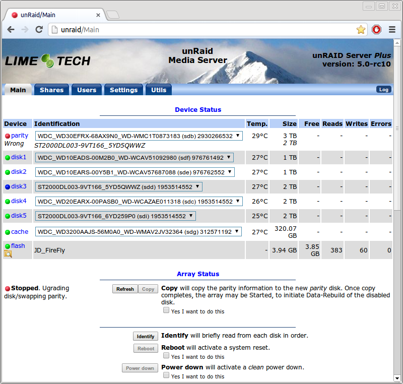

For 'swap disable' you want to assign your "old" parity disk to the disabled disk slot, and assign the "new" parity disk to the parity disk slot, and you should see a button that says 'Copy'.  Looks like that's what happened for you.  So in this state, after clicking Copy please capture and post the system log.

Hi have tried to go through the same process for the past couple of days but run into a strange issue... I have a 2tb drive that failed and swap-disable my 2tb parity disk with a new 3tb WD red. I have preclear the new drive 3 times but always run into a weird issue where the log tells me there is no more space left on the disk.
Here is the part of the log:

I have also attached a screenshot of my Main page showing my drives and the option to copy the parity.
