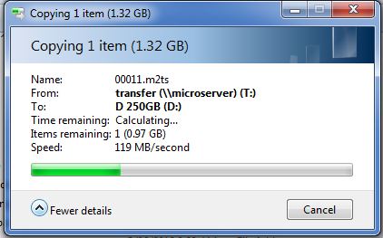

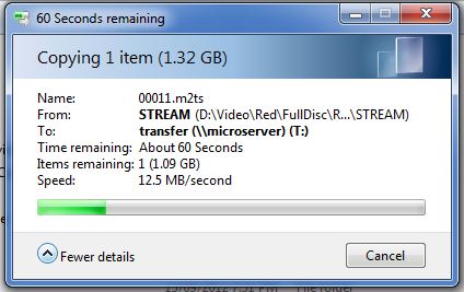

Just uploaded Rc11 to a HP Microserver. Running Basic version so no cache. 14MB upload, 108MB download, I'm happy. I changed from 4.7 to rc10 by just changing bzroot and bzimage then doing the permissions, then to rc11 by just changing bzroot and bzimage. Only plugin is serviio and jre.

How much ram do you have installed, was playing around last night and couldn't get those speeds, and I'm using a cache drive :(
Going to try the limit to 4Gb ram boot option.
You shouldn't need to do that. I'm running 8GB on mine and get max 30MB/sec writes and 60MB/sec reads on the protected array (RC10).
5GB, the original 1 + xtra 4. I just ran it again, hopefully pix attached. The machine is an original N36 with 5GB and 3 x 2TB WD 20EARX drives over Gigabit on Cat 6 cable. Used for video serving and general file server work. Serviio works a treat with my Samsung TV.
have you turned on write cache in the bios??  will improve your write speed by at least 2x
