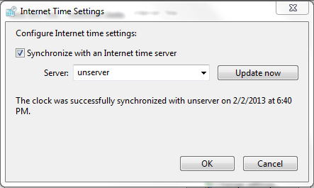

I did not know that Unraid had a NPT server.  Just synced my PC to my unraid server using its IP address.  I hard code the IP in unraid as I noticed in the past that it appears to stop/start the SMB share when renewing the IP address.
I did not try using the hard assigned IP address of my tower.  Glad to know that is an option.  I think I will keep mine pointed to tower opposed to the ip address.  I do not see changing the IP address, but I think there is a greater chance of me changing the IP address than there is a chance of me changing the server name.
