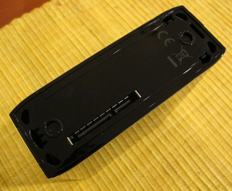

if i am not mistaken, cant you remove teh dock and plug a standard sata and sata power connector into these and do your preclears before you pry them apart?
Yep, the bottom pops off fairly easily without breaking anything or removing the drive.

Here is the bottom of the "external" drive with the meant to be removed adapter removed. No warranty voided to pre clear these.
ZFS on Linux!
