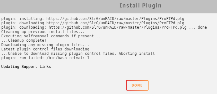

Is there any known problem preventing the download of the "missing plugin control" files?
EDIT: Turns out that my Pihole DNS blocked the download... Should I feel worried? ;)

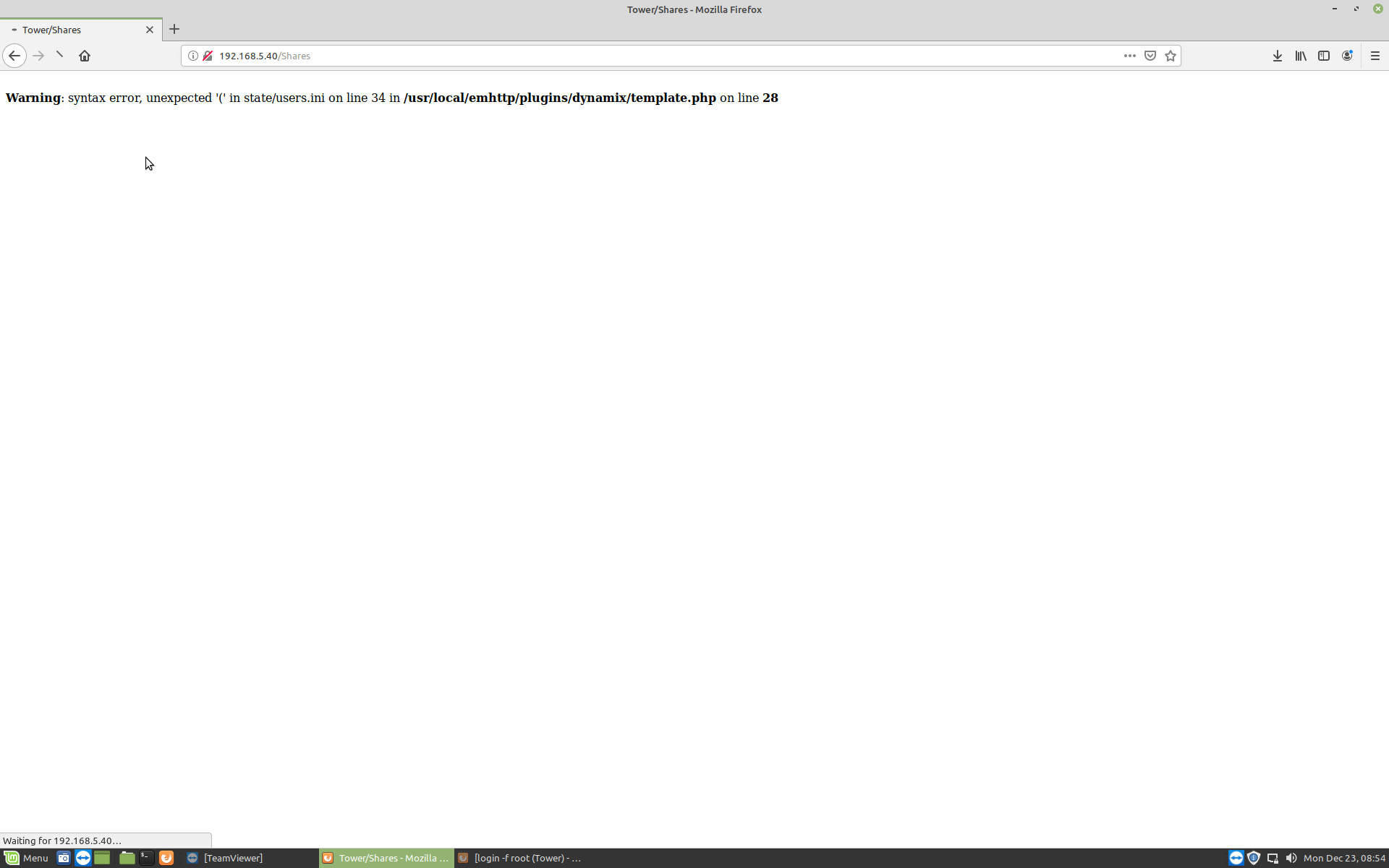

Hi guys.
I edited Description for one user (for FTP access), and put "" in descriptin. After that, I do not have any users under users, but access normally work.
How can I fix that?
Where is file state/users.ini

I can't replicate your problem, as I am not able to enter "" in the comments field, unraid asks me to "Please match the requested format.", so I don't really know, what was going wrong for you. You can check the contents of /etc/shadow, which is the file that contains your unRAID users. A stock shadow file should probably look like this:
root::17990:0:99999:7:::
bin::14824:0:99999:7:::
daemon::14824:0:99999:7:::
adm::14824:0:99999:7:::
lp::14824:0:99999:7:::
mail::14824:0:99999:7:::
news::14824:0:99999:7:::
uucp::14824:0:99999:7:::
ftp::14824:0:99999:7:::
smmsp::14824:0:99999:7:::
mysql::14824:0:99999:7:::
rpc::14824:0:99999:7:::
sshd::14824:0:99999:7:::
oprofile::14824:0:99999:7:::
usbmux::14824:0:99999:7:::
sddm::14824:0:99999:7:::
pulse::14824:0:99999:7:::
avahi:!:14980:0:99999:7:::
avahi-autoipd:!:14980:0:99999:7:::
messagebus:!:14980:0:99999:7:::
pop::14824:0:99999:7:::
haldaemon::14824:0:99999:7:::
polkitd::14824:0:99999:7:::
nobody::14824:0:99999:7:::
tss:!:17825::::::
Though I am not sure, you will have the same "numbers".
If the file looks alright, to you, a reboot will probably fix your problem.

I tried the sftp instructions provided and I think they were very easy to follow and written well, however, i use flashfxp and the rsa key made by unraid gives an error saying 'incorrect algorithm" or something similar when trying to import the key into flashfxp.
I was hoping to find a way to correct this.
Thanks in advance for any ideas or suggestions.
