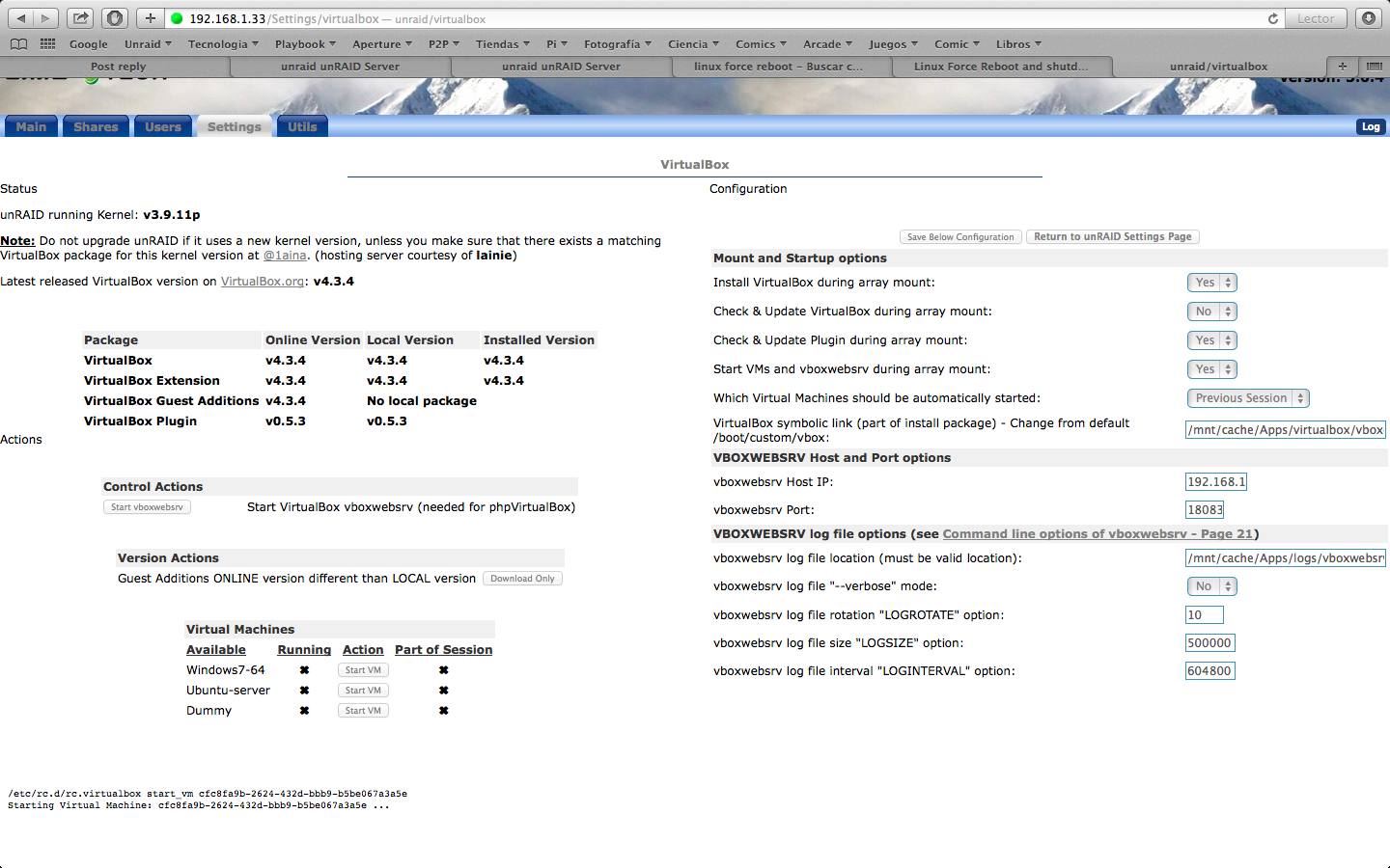

Hey
I dont get VirtualBox up and running, for some reason it doesnt do the following:
  • Show installed version
  • Create logfiles
  • Install extension
Hope you can help me out!

Same issue here... anyone else having similar isssues?
Had the same problem.
http://vbox.a1aina.com/files/vbox-4.3.4-unRAID-3.9.11p.tgz is missing doinst.sh inside /install folder
I added the one from vbox-4.3.2-unRAID-3.9.11p to the archive and the setting page now looks right and I can startup my VM's fine.

That looks exactly like it for me when I went from 5 to 5.03. In my case there was a segfault for libc used by wget in the syslog. never fixed it and downgraded to 5.

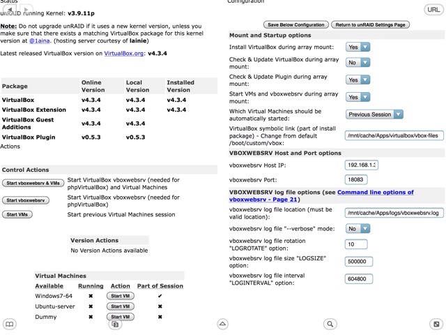

Thanks theone,
Is it neccessary a reboot after update/reinstall?
Still I cant turn on VMs. Log says starting vm but not really
Regards

Can you show you syslog?
What happens when you try and runyour vms from phpvirtualbox?
sure. No error.

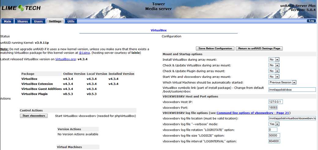

A few notes along the way as I try to do this:
Virtualbox Extensions: while the instructions here say they are included, your instructions here ==> http://vbox.a1aina.com/install.php say they need to be downloaded.  I missed the clue in the OP and then got confused when i looked at your a1aina page, all coupled with the fact that my UnRaid gui showed it was install all conspired to make me confused
lighttpd: AFAIK Simplefeatures is not an option for 5.0 so I went the unmenu route.  I had to dig around to figure out how to configure and actually start lighttpd.  I did figure it out though so for posterity and to save other's time (assuming I did in fact do it right) once you install via unmenu, you have to:
  -- copy the default config from here  /usr/doc/lighttpd-1.4.19/lighttpd.conf to somewhere on your flashdrive.  I choose /boot/packages because that is where the rest of lighttpd is installed by unmenu
  -- then make the following changes
server.document-root = "/mnt/appdisk/lighttpd/virtualbox"  <==== this needs to be a location you created.
server.port          = 8084                                <==== I only choose this because theone did
dir-listing.activate = "enable"                            <==== to be honest I can't validate this but that is the info I found in UnRaid forums
I made no other changes to lighttpd.conf
The command to start lighttpd is:
/usr/sbin/lighttpd start -f /boot/packages/lighttpd.conf
which you should copy to your GO script

I grabbed version 4.3.0 of phpVirtualBox. The only changes I made was to rename config.php-example to config.php aqnd nothing else.
[shadow=red,left][glow=red,2,300]
And now we get to my problem. [/glow][/shadow]

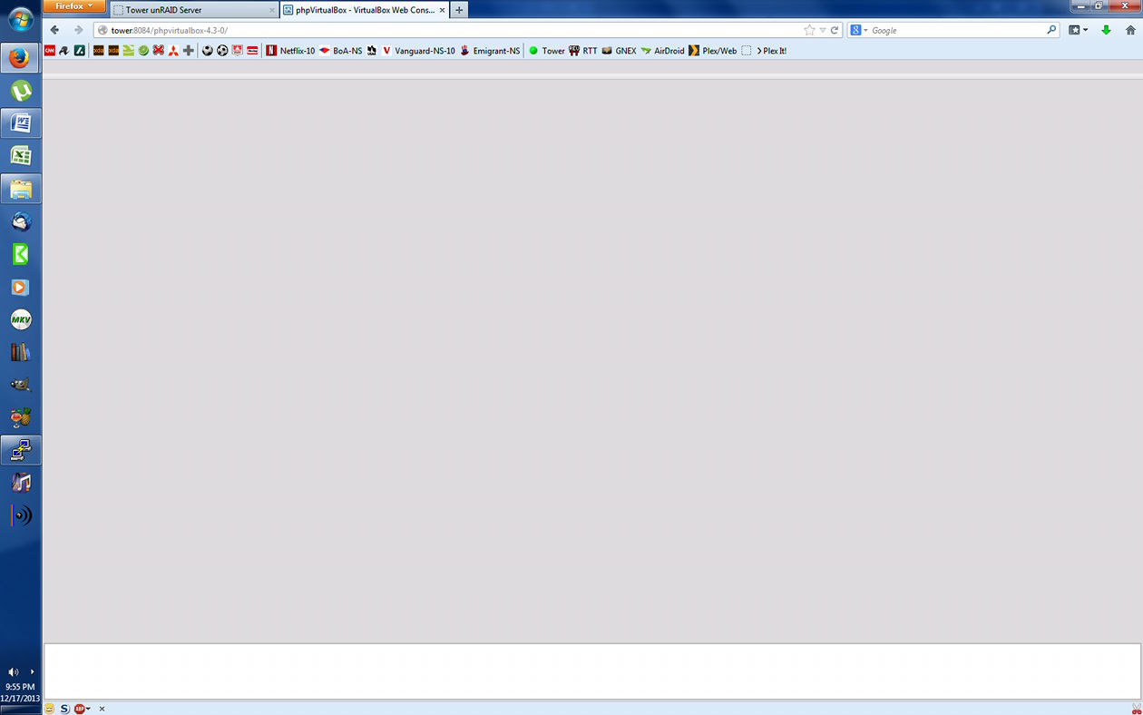

I can't seem to get the web server running.  I click on the Start Vboxwebsrv button and I see
/etc/rc.d/rc.virtualbox start_vboxwebsrv
/opt/VirtualBox/VBoxManage setproperty websrvauthlibrary null
vboxwebsrv service started
But when I go to tower:8084 and click on the folder I put phpVirtualBox in, "phpvirtualbox-4.3-0" all I see is an empty page (attached).  I believe lighttpd is installed correctly because it is serving up the directory of /mnt/appdisk/virtualbox and I can see the "phpvirtualbox-4.3-0" folder.  When I click on that, and get the blank page, the browser tab is named "phpVirtualBox" so I've done something at least partly right re: copying the phpVirtualBox files from the zip i downloaded.
I've also attached a copy of my webgui page and syslog.
For completness the location I set for the logfile does exist and I typed it correctly (compare to my screen shot):
root@Tower:~# cd /mnt/appdisk/virtualbox/
root@Tower:/mnt/appdisk/virtualbox#
but there are no files in there.
The location for the symbolic link:
root@Tower:/mnt/appdisk/virtualbox# cd /mnt/appdisk/vbox
root@Tower:/mnt/appdisk/vbox#
similarly exists and there are indeed files in there.
Any help is greatly appreciated.

Does the unmenu lighttpd install php? If it is only the webserver that gets installed, this is not sufficient to run phpvirtualbox. You also have to install php, make sure lighttpd calls php correctly (mod_fastcgi is installed as a server module) and in php enable the soap extension.
peter_sm is correct (though only partly). I'm using it myself that way.
It doesn't run out of the box however. The SF webserver plugin has to be modified and the soap extension has to be enabled, too. Also the SF webserver plugin might clash with certain plugins and stops working if they are installed.
So it depends a little bit on luck, what plugins you use and ones personal linux skills and/or edurance in reading long forum threads to make it work. ;)
Yeah I'm just not inclined to install Simple Features Base in order to get SF webserver.  Too many problems in the past so now I'm afraid of the fire ;-)
However you are surely right about php not being installed.  I was not aware that I needed that as well.  I'm pretty sure php is available via unmenu and I will take a run at it tonight.  Thank you very much.
FWIW, that detail should probably be part of the instructions even if it is something along the lines of, "install SF web server to get lighttpd and php installed, otherwise you will have to install each yourself."
I'm also planning to update my main post as I go along with these little gems as well my attempts to run a CentOS-VM with PMS, utorrent, and handbrake, as well as a Win7-VM that will be a clone of my PC (fingers crossed on that one haha).  All as a way to get ready for the future of UnRaid-NG or whatever Ironicbadger ends up calling it :)
