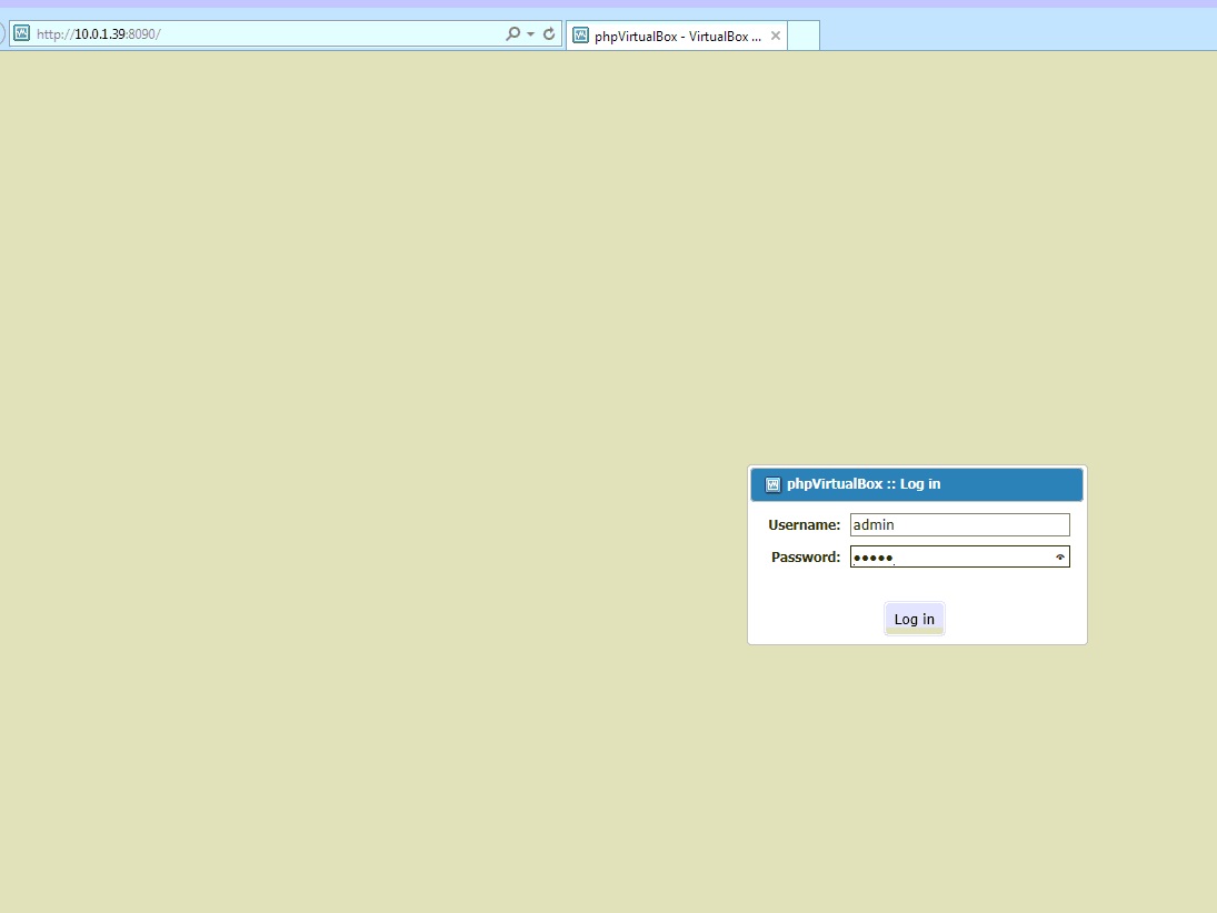

SlrG, care to eloborate or help navigate?  So tried throwing in SF and SF Webserver and I pretty much have the exact same result.

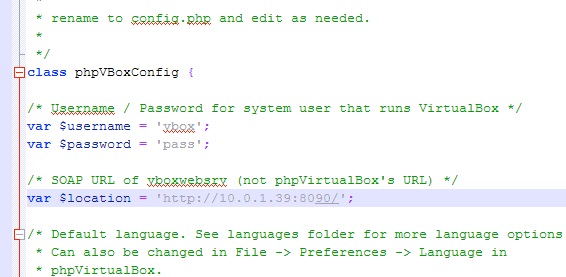

Just want to confirm that the phpvirtualbox files are in the root directory of the web server or that the web server is pointing at the phpvirtualbox files.
I believe the answer is yes.  I put the files in /mnt/appdisk/lighttpd/phpvirtualbox-4.3-0 and then put that same path into the webserver gui.

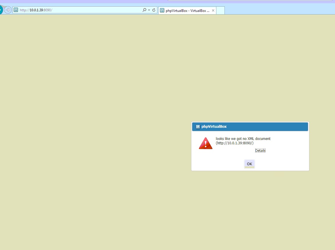

Based on your screen shot it is clear that my webserver is not actually running because i never see the button change to "stop"  I think it is my php config.  Heck to be honest i can't even be 100% sure it is running no less configured right.  You can't use the search term "php" on this forum, you get way too many hits from random scripts and urls etc :o
I'm done mucking about with it tonight though and might not touch it again till the weekend.  I'll have to think on it.  I might just change to installing VB onto my win7 machine.  My only purpose for even doing it is to learn and test and it doesn't have to be on my unraid box for me to learn the intricacies of using VB.

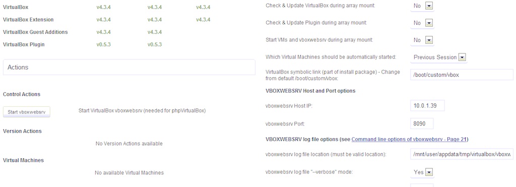

jumperalex, It took me a while to get it all sorted out to work on my end also - I initially went thru the pain of piecing information from several posts and threads to get to the end result - also just got it to work so that i could do the same and play around with the virtual environment from within unraid.
but no matter what there's a plethora of experienced and novice users to help each other out and what ever you need to get it to work, just recommend you keep posting your status updates and roadblocks so that everyone can assist.
Also wanted to clarify do you have lighttpd from unmenu and SF web server installed?
thanks i appreciate it.
So right now I'm in the middle of building a fedora VM from the ISO on my win7-host, while doing a handbrake transcode ... its ummm.... slow haha but showing me how robust it all is.
As for unRaid I removed the lighttpd and php packages from unmenu and then installed SF-Core and SF-Webserver only.  My understanding is that installs lighttpd (i can clearly see it does) and php together, but I'm clearly having problems on that last bit.

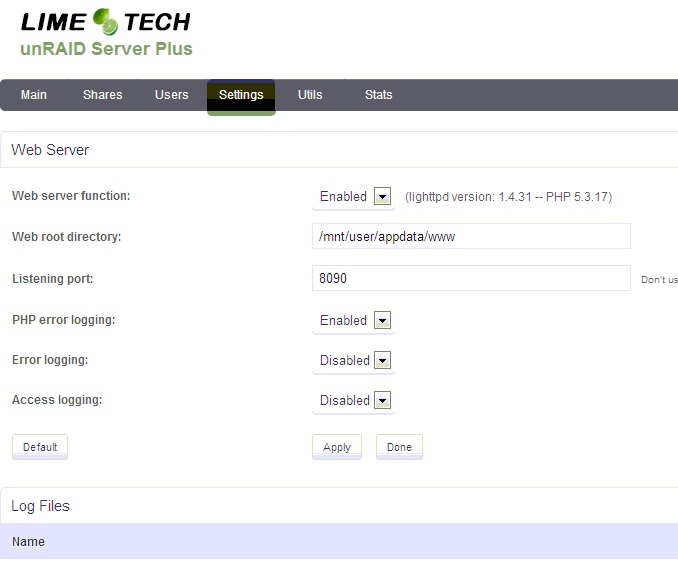

Does the SF webserver actually say it is running? Did you modify the plugin to load the correct sqlite package? (See here.) What other plugins do you have running? Please check that there is none that installs the older openssl package version 0.9.x. You need openssl-solibs-1.0.1c-i486-3.txz.
Q: Does the SF webserver actually say it is running?
A: The icon showed up in the Settings tab, I told it where my web root directory was, set port to 8084, and enabled it.
I did not turn on php error logging which might have given me some clues, but I got annoyed and start my win-7 install.  Which went well after a fashion and I now have a Fedora 20 VM (woot!).  Gonna try CentOS next and then start banging around trying to break it, errr learn how it all works ;-)  I really need to learn more about LMV.  I also probably need a bigger SSD :o
Q: Did you modify the plugin to load the correct sqlite package? (See here.)
A: I did not.  I had no idea.  I will look at that link and get cracking.
Q: What other plugins do you have running? Please check that there is none that installs the older openssl package version 0.9.x. You need openssl-solibs-1.0.1c-i486-3.txz.
A: unMenu, plex, screen, apcupsd, openSSH, bpmon (or whatever it is called), and maybe one or two other unMenu packages, but the important one I'm sure then is openSSH because it does in fact install openSSL.  I will check to see what version I have.  It has an update feature I haven't checked in a while so it might even be ready to install 1.0.1c if it hasn't already.
Thanks for your help.

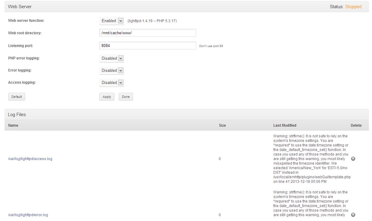

Hey everyone. Been trying to get this going for a couple days now but it just doesn't seem to work. I believe the plugin is running and active, but I'm not sure of the web server is working. When I click the "Start vboxwebserv" button it says its starting but nothing changes after the page refreshes. The log says this though.
"Dec 20 14:11:32 Tank01 rc.virtualbox[15137]: /opt/VirtualBox/VBoxManage setproperty websrvauthlibrary null
Dec 20 14:11:32 Tank01 rc.virtualbox[15139]: vboxwebsrv service started"
If I try to go to the page 10.x.x.x:8084 nothing comes up. Just the Chrome Oops page. Clicking the Web Server button and enabling that will not start either. I've attached a few screenshots. Any idea what I'm doing wrong? Lastly, I read that the error I'm getting in the second jpg could be causing problems. How can I resolve that?

Your webserver is not running as the status says "Stopped". You propably have another plugin installed, that installs an older ssl version as is needed by the SF webserver. Or you didn't edit the plugin file to download the correct sqlite package. If you did everything correctly the status should state "Running".
Is it possible to safely remove any existing web server plugins so I can start over? Any idea how I would do this?
EDIT: Something I just noticed after a reboot. In the Web Server section before selecting Enabled I see this.
"Warning: parse_ini_file(/var/local/emhttp/simpleFeatures.web.server.ini): failed to open stream: No such file or directory in /usr/local/emhttp/plugins/simpleFeatures.webServer/WEBsettings.php on line 11"
Thanks
SUCCESS!!!
Well except now i need to install SOAP?!?!?!

@jumperalex:
You don't need to install SOAP. You have to enable it. Edit the php.ini file in /boot/config/simpleFeatures/ search for the line ;extension=soap.so and remove the ; in front of it.
Disable and reenable the webserver. That's it.
@Indy1204:
I think you need to install the SF base plugin. Having only the webserver one will not work.

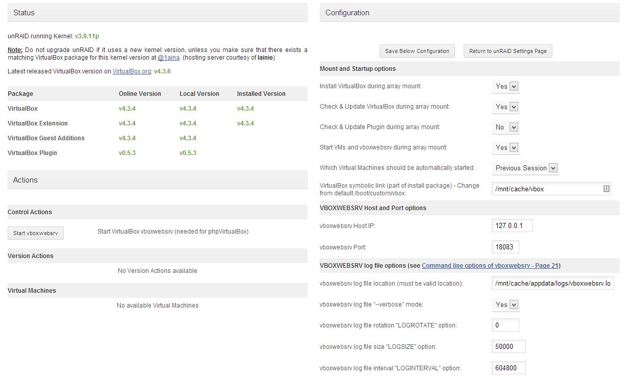

Hi All
I seem to have run into a problem getting vboxwebsrv to start, when I hit the "start vboxwebsrv" button in the gui it seems to pause for a bit and then come back and the start button is still visible.
I am running a cache drive so I have changed the symbolic link to /mnt/cache/VMHDD/vbox.
I have also change the vboxwebsrv.log location to /mnt/cache/VMHDD/vboxwebsrv.log. I noticed there was no log fill in this location so I created one and nothing is written to it at all. I did have this plugin working a while back but removed it now I at trying to add it again.

Same exact problem! Don't know how to solve it
Look at the log file created inside the vbox folder. What does it say?

So VBoxSVC.log says
VirtualBox XPCOM Server 4.3.4 r91027 linux.x86 (Nov 29 2013 16:39:43) release log
00:00:00.001372 main     Log opened 2013-12-23T11:54:01.912949000Z
00:00:00.001377 main     Build Type: release
00:00:00.001386 main     OS Product: Linux
00:00:00.001391 main     OS Release: 3.9.11p-unRAID
00:00:00.001396 main     OS Version: #3 SMP Wed Oct 30 13:17:02 PDT 2013
00:00:00.001579 main     Host RAM: 2024MB total, 1564MB available
00:00:00.001592 main     Executable: /opt/VirtualBox/VBoxSVC
00:00:00.001595 main     Process ID: 8304
00:00:00.001598 main     Package type: LINUX_32BITS_GENERIC
00:00:00.119862 nspr-2   Loading settings file "/root/.VirtualBox/VirtualBox.xml" with version "1.12-linux"
00:00:00.129278 nspr-2   VDInit finished
00:00:08.077543 Watcher  ERROR [COM]: aRC=E_ACCESSDENIED (0x80070005) aIID={fafa4e17-1ee2-4905-a10e-fe7c18bf5554} aComponent={VirtualBox} aText={The object is not ready}, preserve=false
While in the syslog I only see two lines
Dec 23 12:53:46 Server rc.virtualbox[8220]: /opt/VirtualBox/VBoxManage setproperty websrvauthlibrary null
Dec 23 12:53:46 Server rc.virtualbox[8222]: vboxwebsrv service started
I'm using version 5.0.2
Suggestions?
I have manage to get SF web server install and on port 8090, got phpvirtualbox extracted to my root /www and configure the config.php and i thought i hit jack pot when the phpvirtualbox login pop up ( i left the login as admin admin) but i get the error "looks like there is no xml document" i;ve read the manuals but can seem to figure out why i get this. I will attach screen shots
here is the other ones
