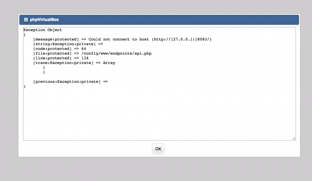

Last couple of days / week tried several times to login with phpvirtualbox.
To no avail, obviously.
So what is wrong?
Everything required is running (virtualbox, vboxwebsrv) and I get to he login page, but not even the default admin / admin works. Recovery.php (to reset the default admin / admin) does not work either.
Setting var $noAuth = true; lets me in (without username / password, as expected).
But I  would prefer to really login.
Any thoughts?
Permissions issue?
Any thoughts?
Permissions issue?
Which webserver are you using to host phpvirtualbox?
I'm using the Apache webserver by dmacias72. As a direct plugin; not using a dockerized webserver.
I'm using the same webserver plugin, and I just turned on authentication and ssl in the webserver instead of using the phpvirtualbox authentication. Makes it much easier as I just have a single ssl login to get to several reverse proxied hosts as well as the phpvirtualbox.
