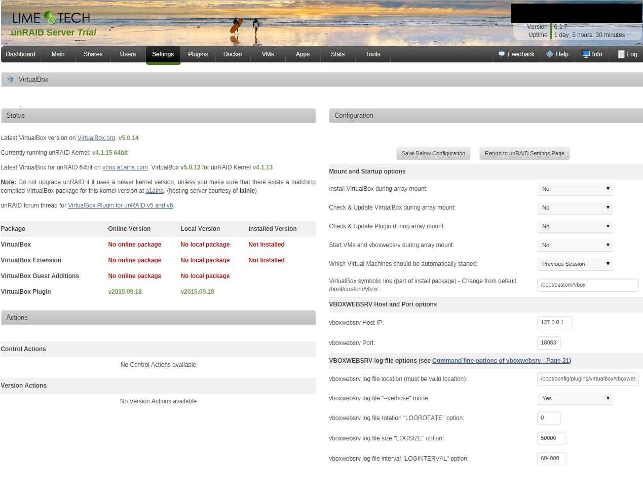

I'm new to Unraid and this virtualbox plugin.
I installed it, but its not working. I could not find any tutorial or "getting started" blog post on this.
I do see the webui with some config options but thats it.. it doesn't have a "add VM" button.
What should i enable to enable such a button?
And should i install phpVirtualbox? If so, mentioning that and adding link to that plugin in the 1st post would be of great use for noobs like me.
And the Help button does nothing. Mentioning the "goto defaults to get things working" would be practical.
Or do the "No online package No local package Not Installed" indicators mean i should "wait for laine" ?
Yes
Should be up now.

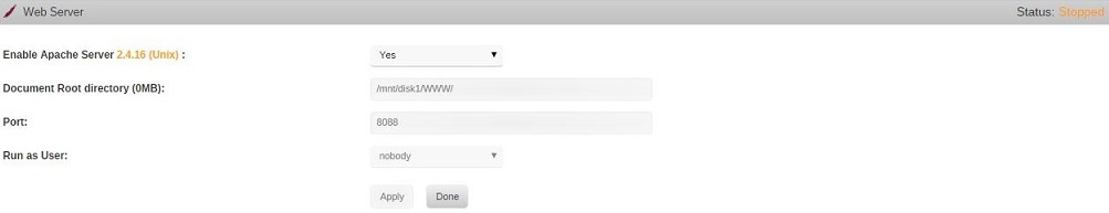

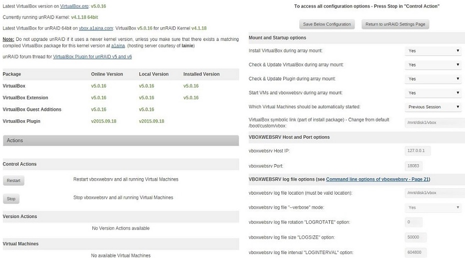

Please post:
* screenshot of webserver plugin page
* screenshot of webserver folder you defined
* what URL address you are using to access phpvirtualbox
* screenshot of virtualbox plugin page
Please post:
attached all,

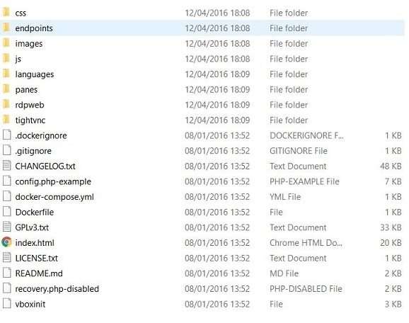

trying to connect to 10.0.0.11:18083 which is my unraid IP address.
You should try to connect to 10.0.0.11:8088
What is the folder structrure under /mnt/disk1/WWW?
I also tried that...
went into webpage with header: Guacamole 0.9.6.
