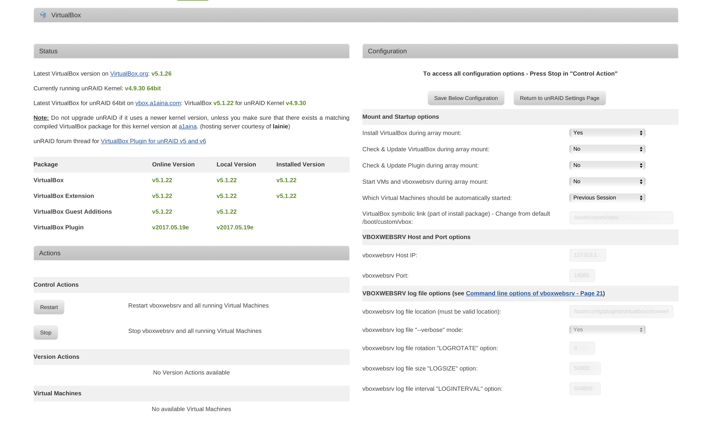

Virtualbox
  • Virtualbox v5.1.22 local version and installed version
  • virtualbox extension v5.1.22 local version and installed version
  • virtualbox guest additions local version and NOT showing an installed version
  • virtualbox plugin v2017.05.19e
  • VirtualbBox symbolic link set to: /boot/custom/vbox  (Two things I do not see this folder on unraid and do I need to change this location so it is not on the flash drive?)   (I created the folder "custom" and then added the folder "vbox" to get /boot/custom/vbox .... not sure if this is needed)
  • vboxwebsrv host IP: 127.0.0.1
  • vboxwebsrv Port 18083
  • Vboxwebserver log file location /boot/config/plugins/virtualbox/vbox   (verbose mode YES) (just checked this location on the flash drive and there is no folder "vbox" under  /boot/config/plugins/virtualbox)   (I added the folder "vbox"  ..... not sure if this is needed)   (after doing the below and watching the folder, nothing appeared in vbox....)

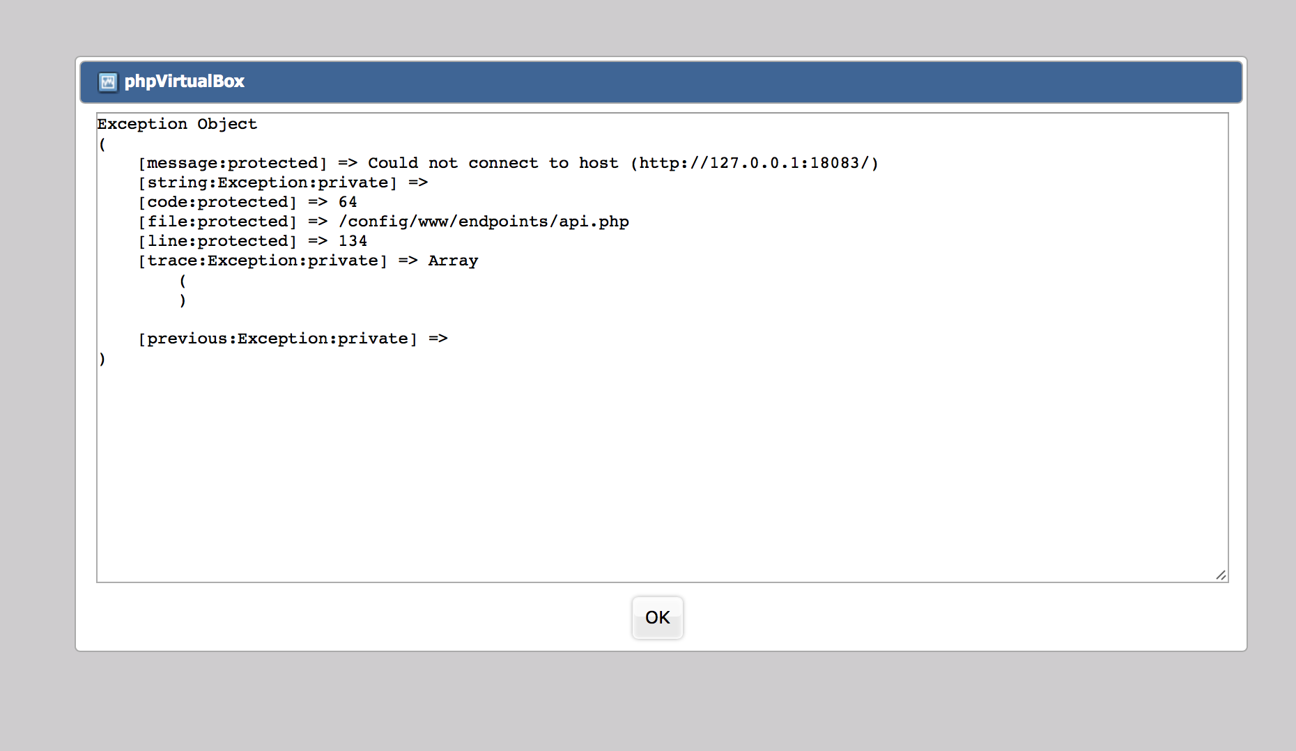

  • Opened a New Chrome Tab and went to http:\\tower/phpvb/  or IP Address/phpvb
  • By the way I have no VM's running plenty of Ram and space, and once I start the above process, I have to use terminal to do a "PowerDown"  this process locks up the gui screen and I can not gain access to any part of gui from any computer or from the screen connected to the tower.
At the very bottom of the Virtualbox plugin tab it says: "/opt/VirtualBox/VBoxManage setproperty websrvauthlibrary null vboxwebsrv service started"
I saw the phpVirtualbox GUI but it was light (still loading) after waiting five minutes or so I refreshed and then the light outline of the GUI shows for a second and then goes away and does not come back and I get the message:
"An error occurred communicating with your vboxwebsrv. No more requests will be sent by phpVirtualBox until the error is corrected and this page is refreshed. The details of this connection error should be displayed in a subsequent dialog box."
and the message:
"Could not connect to host (http://127.0.0.1:18083/)[code]
Exception Object
    [message:protected] => Could not connect to host (http://127.0.0.1:18083/)
    [string:Exception:private] =>
    [code:protected] => 64
    [file:protected] => /config/www/phpvb/endpoints/lib/vboxconnector.php
    [line:protected] => 220

Attempting to dig some more on this and get this working, I noticed in an error log something about certificate/s.  Could my issue be related to SSL Certificates.  It looks like there are a cert.crt, with cert.key file but it is under apache keys.
  • 2 months later...

Post a screenshot of the virtualbox plugin page.  What Apache are you using (Docker/plugin and author)?

Below is a screenshot of what it looks like after clicking "start vboxwebsrv"
33 minutes ago, Halon314 said:
I understand what you mean about the page not updating - but no, it's actually unresponsive.  I try refreshing / opening the UI in a new tab / other laptop, etc.  It will not load.
Been too long since I set this up, can't do it from memory.  Will look at it this evening when I get home to see if I can figure out what may be happening.  What web server you are using (Docker/plugin, author)  and phpVirtualBox configuration?
