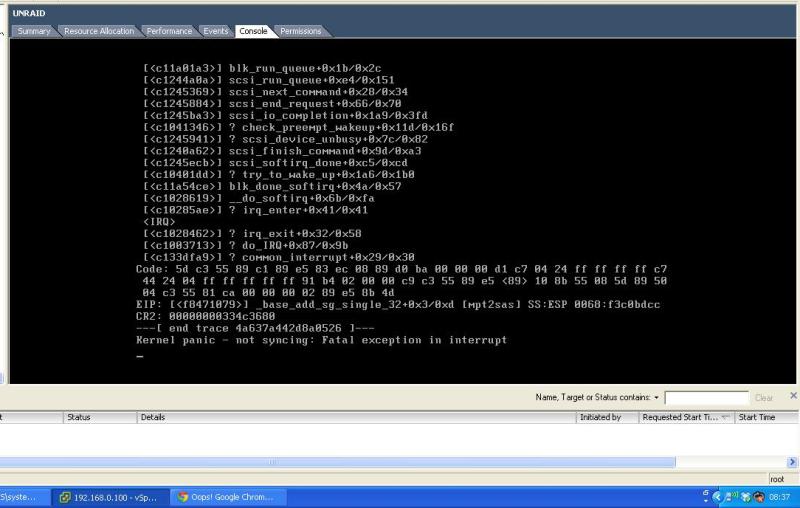

What does the kernel panic say?

heres the image of the panic

a quick google suggests or points to memory/memory timing/voltage.  The board im using is a overclockers/gamers board (good specs inthe pci-e) will check the memory timings (they should be as default will check though tomorrow)
