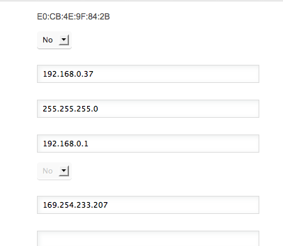

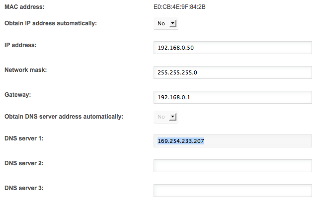

then i restarted the machine and all goes well. exept it will not use my dns server settings. in the webgui i see 169.254.233.207 insted of the dns i have manually put in.
What is going wrong. This way i cant install much plugins, like crashplan.
pls help, i already restarted the machine a dozen times and tried to set dhcp but that also doesnt work anymore. at least not for dns.

When i edit the network settings in the web gui it is saving the network.cfg. But in the interface its not showing the new settings. It keeps showing: 169.254.233.207
Enyone has an idea whats going on?

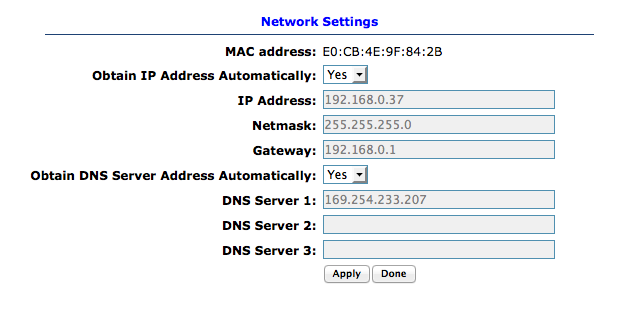

Now tried to set all to dhcp and reboot the machine. this is now the outcome:
# Generated settings:^M
USE_DHCP="yes"^M
IPADDR="192.168.0.15"^M
NETMASK="255.255.255.0"^M
GATEWAY="192.168.0.1"^M
DHCP_KEEPRESOLV="no"^M
DNS_SERVER1="169.254.233.207"^M
DNS_SERVER2=""^M
DNS_SERVER3=""^M
what is really strange. because the webinterface is showing the attachment.
so it looks like the machine is not using the network.cfg anymore. but somehow knowing that it should get an dhcp address

Those screen shots show the system set to use DHCP!  If you want to set the address manually, then the options to get the address automatically should be set to No.
Well i tried manual, and dhcp. and dhcp seems even more a pain..

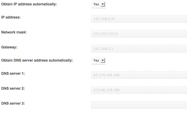

Atm it is working with dhcp. i did a reboot on my modem and switch and unraid machine.
This is how it looks right now. (see attchment)
but the network.cfg looks like this atm:

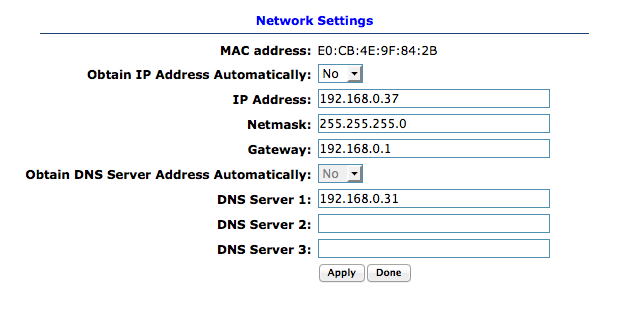

DNS_SERVER3=""
and the web gui says 192.168.0.31
so its just not taking over the network.cfg dns setting
syslog.txt
