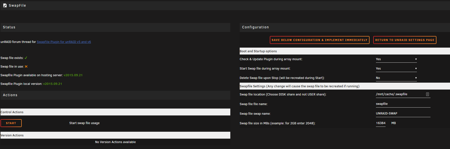

So im on BRFS and have set things up but i cant seem to get it to use said swap file
Clicking start does nothing

Im having the same issue.
Mine is set to "/mnt/cache-nvme/swap/" so I ran the below commands;
- cd /mnt/cache-nvme/swap/
- truncate -s 0 ./swapfile
- chattr +C ./swapfile
- btrfs property set ./swapfile compression none
everything looks fine, and I don't get any errors.
I see "Swap file exists: ✔" but when I click "start" nothing happens and it still shows "Swap file in use: ✖"
I have had the same issue with the plugin before, particularly when using large swapfiles. Run
swapon /mnt/cache-nvme/swap/swapfile
@primeval_god thanks for the tip, I tried running the command and got the following output, and the swap is still not enabled.
swapon: /mnt/cache-nvme/swap/swapfile: insecure permissions 0666, 0600 suggested.
swapon: /mnt/cache-nvme/swap/swapfile: read swap header failed
After some googling I see people using other Linux distorts running “mkswap”, but they are all referring to a swap partition. I’m not sure if that’s the correct fix for unraid.

No you definitely need to run mkswap on the file before using it. I didnt notice that the steps you had posted skipped that. Your missing steps are (note 1G for a 1GB swapfile).
fallocate -l 1G /mnt/cache-nvme/swap/swapfile
chmod 600 /mnt/cache-nvme/swap/swapfile
mkswap /mnt/cache-nvme/swap/swapfile
Edited by primeval_god
Thank you for laying that out for me, I had no idea those steps were required to make this plugin work. But it is definitely working now.
oom errors are rare, but it's nice to have a safety net now.
