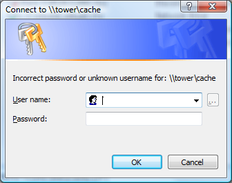

I Can't access unRAID user, disk shares and flash drive from Windows - I need help
* I have no users defined under unRAID except root
* I can access WEBUI
* I can access via telnet
* I tried restarting Windows
disk share propeties:

I get the following window:
I don't think the recent versions of unRAID allow share access by root. Create a user in the webGUI and give it access to your shares.
If you use the same username and password as your windows user you won't even have to login to access a share.
I have been using RC8a since it came out - moved from 4.7 - did the new permissions then
Then moved to RC10 when it came out - again did the new permissions as required
and moved to RC11 a few days ago
I didn't have any problems and never had any user but "root"
Can't access shares from smart phone as well.
I will restart the server and see if it helps
So restart solved the permissions problem.
