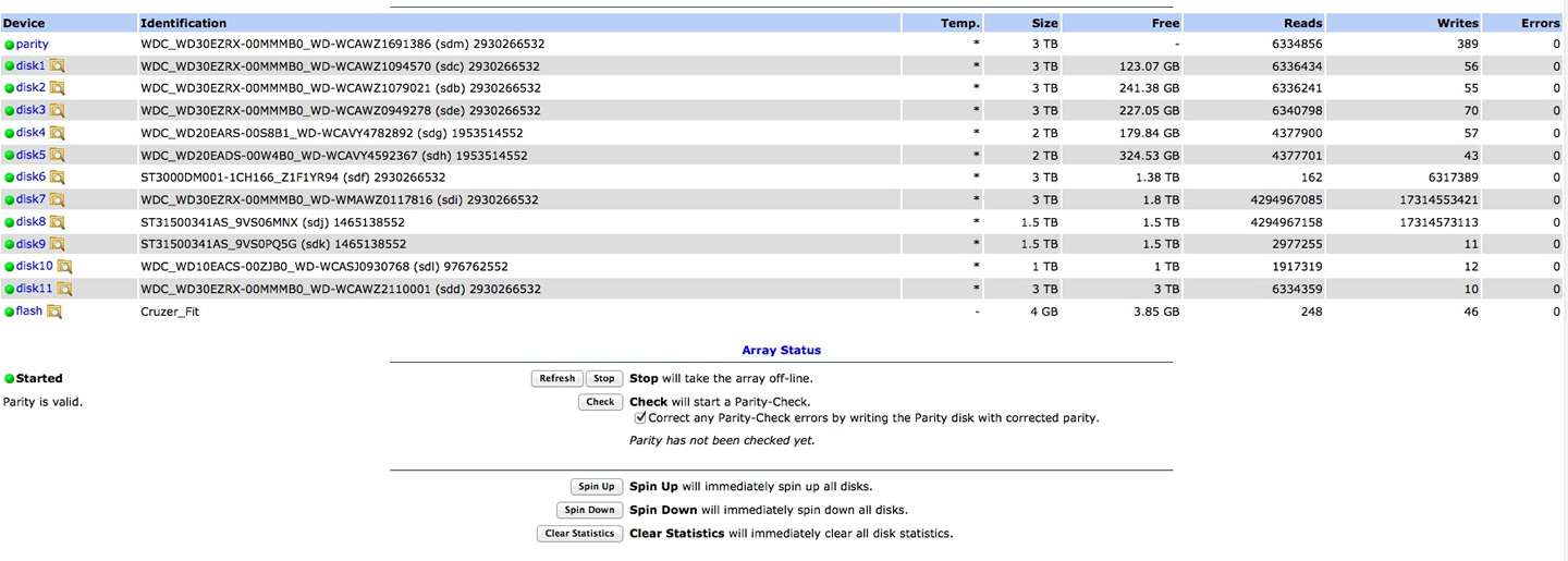

Now- one last question, to anyone who might know: I have successfully rebuilt the disk, and all appears to be well. I have not used the array since completion (haven't written any new data to it, nor deleted anything), and I am curious as to why I would suddenly have all these writes to my disks 7 and 8, including 17314573113 writes to an empty drive!
I'm attaching a screenshot. Hopefully this is nothing to worry about.
From a parity standpoint or a rebuilding standpoint, file contents are completely irrelevant, so the drive being empty does not matter at all.  However, those Disk 7 and Disk 8 read and write numbers are clearly very wrong, and look like a variable overwrite.  All other numbers look correct.  Does the syslog show anything odd during this period?  Have you done a long memory test?
If those numbers were right, then Disk 7 and Disk 8 were read a thousand times as many times as the others, and written to 3000 times as much as the drive that was rebuilt, which would take roughly 3000 times as long as the time it took to rebuild Disk 6!  (Maybe 3 or 4 years?)
I would shut down and reboot, in case there is internal corruption.  Then when convenient for you, do a full parity check.

Apparently my cat decided the pull out the power connection to those 2 drives at some point. I think the rebuild was complete, or almost complete, when he did this - I only noticed it when those 2 disks came up as "not installed"! I shut down, re-connected power, and have now run a full parity check- which came up with 6 errors. So, who knows. Not sure whether I lost anything or not, but everything SEEMS ok so far.
