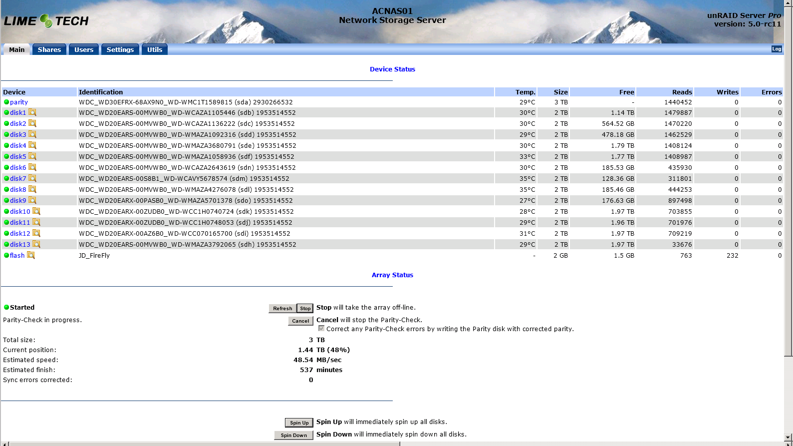

RC11 on X9SCL-F-O LGA w/ i3-2100 slow Parity Checks with new SAS2LP-MV8
It all started when I added the remaining 4 drives to my SASLP-MV8.  Previous to this I was using the 6 ports on the mobo and 4 ports on the SASLP-MV8 running unraid 4.7.  With only 4 drives on the SASLP-MV8 parity checks were 100MB/s and ended in the 70MB/s range.  All 2TB Ears or Earx.  After adding the remain 4 drives to the SASLP-MV8 my parity checks went down to 70MB/s constant.    So to me that looked like a bandwidth restriction on the 4X PCIe bus.  So I went out and got the SAS2LP-MV8.  Upgraded unraid to 5RC11.  The parity check then drop to less than 50MB/sec.  I checked my smart status on the drives and noticed two  "current pending sector" on the parity drive (2tb ears).  Order a 3TB WD red and pre-cleared.  Added it to the array and re-built speed of the parity drive started at 108MB/s.  At the ended of 2TB it was 60MB/s and averaged 75MB/s overall.  Sounds like the drive was the slowdown and I have fixed my bottleneck.  Nope this morning I started a parity check to make sure the parity re-built was correct and it is checking at less the 50MB/s again.  I am running unmenu with very little packages installed (APC, PHP, smart history)  I ran the user script to check hard drive speeds and they all show 100+MB/s.  I do have the SAS2LP-MV8 installed in a 8X PCIe slot.  I'm guessing this is why Unraid is still a RC.  Any suggestion on how to restore my parity check speed?
parity WDC_WD30EFRX-68AX9N0_WD-WMC1T1589815    (sda) 2930266532  30°C 3 TB
disk1  WDC_WD20EARS-00MVWB0_WD-WCAZA1105446  (sdb) 1953514552  30°C 2 TB
disk2  WDC_WD20EARS-00MVWB0_WD-WCAZA1136222  (sdc)  1953514552    30°C 2 TB
disk3  WDC_WD20EARS-00MVWB0_WD-WMAZA1092316  (sdd) 1953514552    29°C 2 TB
disk4  WDC_WD20EARS-00MVWB0_WD-WMAZA3680791  (sde) 1953514552    30°C 2 TB
disk5  WDC_WD20EARS-00MVWB0_WD-WMAZA1058936  (sdf)  1953514552    34°C 2 TB
disk6  WDC_WD20EARS-00MVWB0_WD-WCAZA2643619  (sdn) 1953514552    30°C 2 TB
disk7  WDC_WD20EARS-00S8B1_WD-WCAVY5678574      (sdm) 1953514552  35°C 2 TB
disk8  WDC_WD20EARS-00MVWB0_WD-WMAZA4276078  (sdl)  1953514552    35°C 2 TB
disk9  WDC_WD20EARX-00PASB0_WD-WMAZA5701378    (sdo) 1953514552    27°C 2 TB
disk10 WDC_WD20EARX-00ZUDB0_WD-WCC1H0740724  (sdk) 1953514552    28°C 2 TB
disk11 WDC_WD20EARX-00ZUDB0_WD-WCC1H0748053  (sdj)  1953514552    29°C 2 TB
disk12 WDC_WD20EARX-00AZ6B0_WD-WCC070165700    (sdi)  1953514552    32°C 2 TB
disk13 WDC_WD20EARS-00MVWB0_WD-WMAZA3792065  (sdh) 1953514552    29°C 2 TB
flash  JD_FireFly - 2 GB 1.5 GB 763 232 0
syslog-2013-02-11.txt
I decided to put a picture of the parity check.  I hit clear statistics and after a while I hit refresh and I notice the reads off each disk were different.  The first 6 disk are running off the onboard controller.  The last 8 are running off the SAS2LP-MV8.  Is this normal?

Once pass 2T the parity check went to 112MB/s and ended at 80MB/s.  The Mobo has 2 PCIe  v2.0 8x and 1 PCIe v2.0 4x in a 8x slot.  The old SASLP-MV8 was 4x and the SAS2LP-MV8 is 8x.
It is the fact that the SASLP-MV8 slowed down when I filled all 8 ports.  It is a 4x card that is maxed out at 75MB/s with 8 drives attatched.
I changed the  card out for the SAS2LP-MV8 (8x) and I stayed at 50MB/s for the whole 2TB on parity check.  That is why I changed the parity drive, it showed errors.  I don't have a backplane, just direct cable connects.  I might have to check cables once more and maybe change out.  After I  replace the parity drive I did a re-build of the parity drive.  Rebuild started out a 110MB/s.  At 2TB it was 60MB/s.  Then from 2-3TB it was 112-80MB/s.  Once the array was protected and up and running I did a parity check.  The check stayed at 50MB/s for the first 2TB and went up to 112MB/s.  It makes no sense to me.  The parity check just reads from all drives and the parity rebuild reads from 13 and writes to 1.
Not sure which part doesn't make sense, if it's the part where speed drops until the 2TB mark, then speeds up much higher, please see the Parity Check Speed section of the Improving unRAID Performance wiki page for an explanation.
If what doesn't make sense is the 50MB/s top speed during the first 2TB, yes that is a little troubling.  You may have reached the real world performance level of that combination of hardware.  Just one idea, have you seen this post by dheg, and the associated thread.  Any chance it could apply to your card too?  Or perhaps there is a similar update for it?
I think the EARS and EARX drive operate at about 110MBps maximum so 8 of them will not saturate a PCIe x4 1.1 bus.
Each lane of the PCIe v1.x interface will, theoretically, run at 250MB/s.  Four lanes will give 1000MB/s.  Real world performance may approach 800MB/s.  Eight drives, at 110MB/s would add up to 880MB/s and can, therefore, saturate a PCIe V1.x x4 connection.

Here is my log during the parity check.  It is a real boring read.  I'm guessing it is a driver issue with the SAS2LP-MV8.  The avg parity check speed is 57MB/s.  Might just stick the SASLP-MV8 back in for now.
Feb 11 05:37:30 ACNAS01 kernel: mdcmd (71): check CORRECT
Feb 11 05:37:30 ACNAS01 kernel: md: recovery thread woken up ...
Feb 11 05:37:30 ACNAS01 kernel: md: recovery thread checking parity...
Feb 11 05:37:30 ACNAS01 kernel: md: using 1536k window, over a total of 2930266532 blocks.
