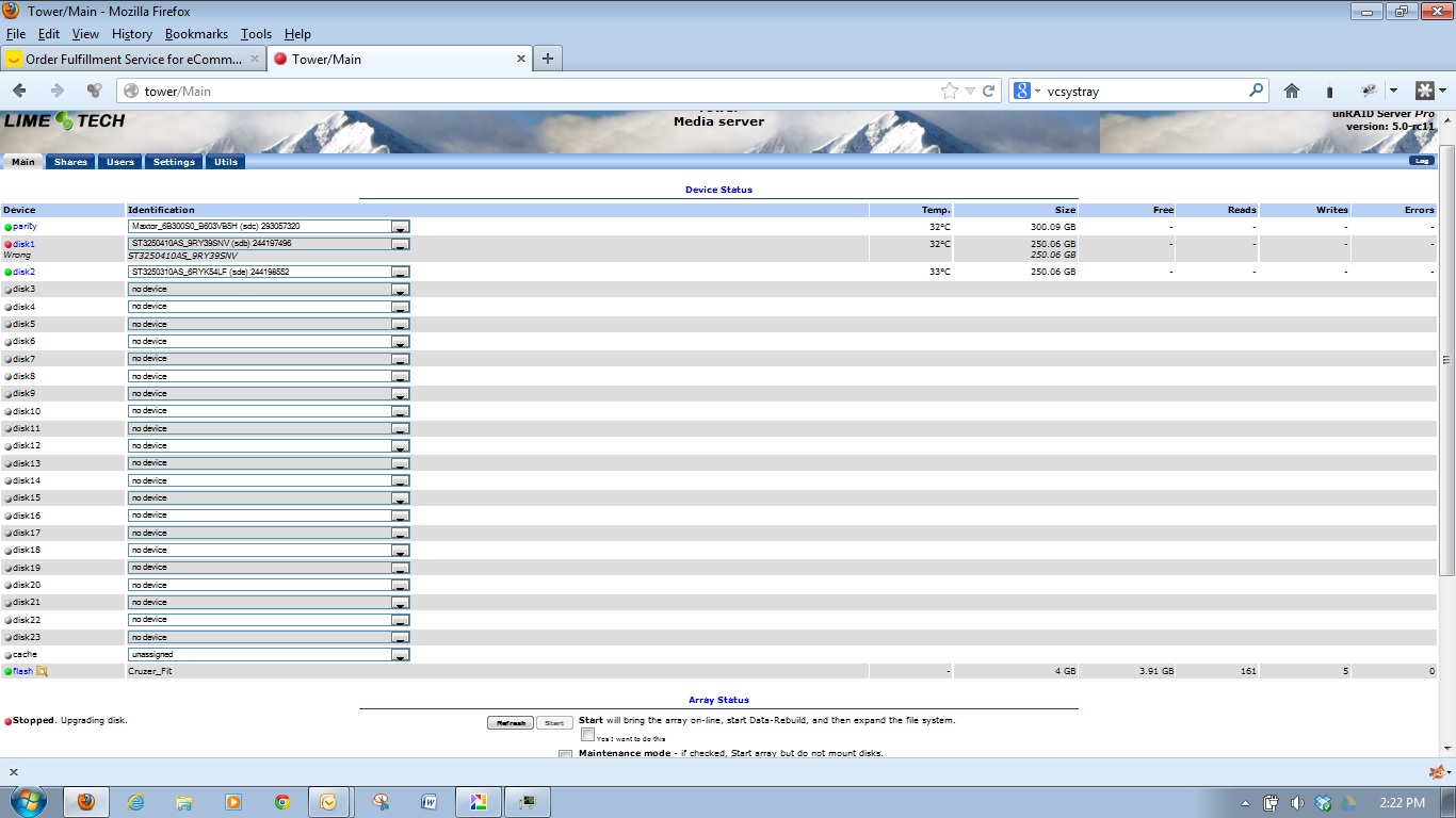

Upgraded to 5.0 rc-11
Server rebooted with one of the 2 data disks showing as "wrong" http://screencast.com/t/ihPa1Jn8QDTU.
At a loss on how to move forward.
I am willing to wipe this server clean and start over (data is not crucial)...  Would like to avoid "pre-clear time" if possible...

Please attach a screenshot of the entire window.
Will this work?  192k file limit is making a good screen shot a bit difficult...
The disk is being identified differently by the new OS. Starting the array will rebuild the disk and all should be well.
Umm...  I thought I tried that option and that the start array buttons were greyed out...  I am traveling and will revisit in 3 days when I return, but I am 90% sure that starting the array was not an option...
Could be wrong...  Will advise...
