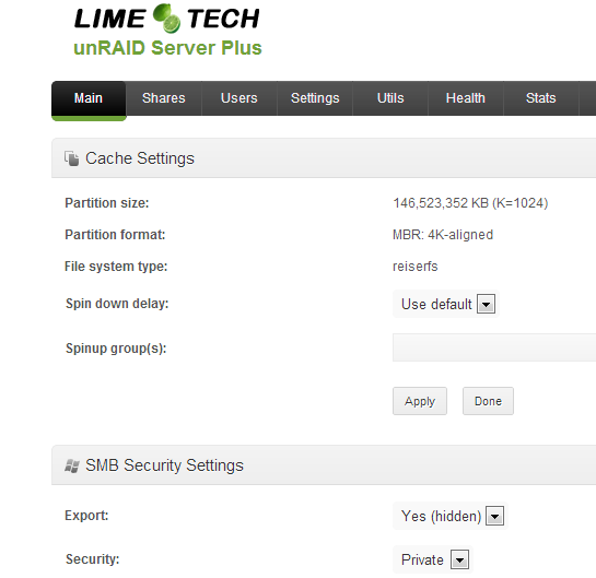

What are the SMB security settings for your cache disk? From Main click cache.

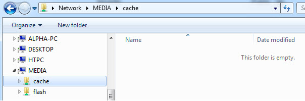

sorry, i don't think i was clear before.  I can see the share "cache" in windows, but when i select it, windows shows it to be empty (first screenshot)
If I navigate to it with PuTTy, i can see the contents (second screenshot)
My cache settings pretty much match yours, but I have mine as Public, not hidden, otherwise the same.
