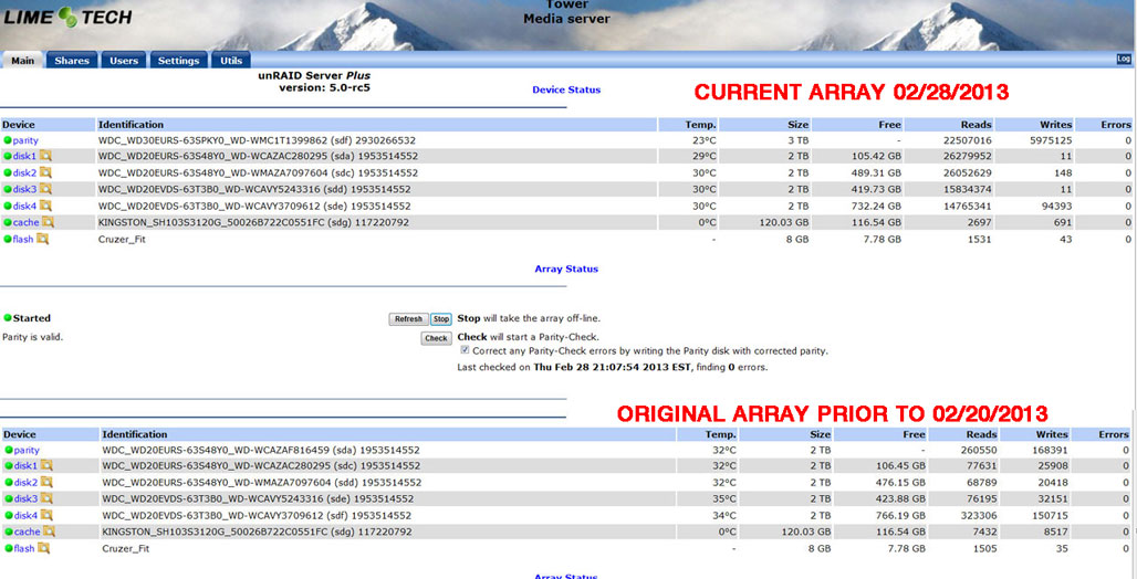

Little bit about my back ground first. I build & maintain systems for a major utility company in the north east (this is however my first foray into Linux as I am not a software engineer), we work mainly with windows server systems. I build custom gaming systems/mod the cases of many of my friends as a hobby and even have a few dedicated business customers (DBA, looking at retirement...lol).
Now for the System hardware (mentioned previously in the first post of this thread):
Intel i3-530 (running stock specs),
Gigabyte GA-H57M-USB3 (most current bios, but it is still 2010, USB3 turned off & Sata controllers set to ahci, no other tweaks),
G.Skill F3-10666CL9D-8GBRL (running at stock timings), (Memtest86+ x10 twice)
1 x WD30EURS-63SPKYO 3TB (PARITY)
2 X WD20EURS-63S48Y0 2TB (ARRAY)
2 X WD20EVDS-63STB0 2TB (ARRAY)
1 X KINGSTON SH103S3120C 3K SSD (CACHE - is this too small? I only use it for running plex at this time)
1 X CRUZER FIT 8GB USB (OS)
PC POWER & COOLING -Silencer 750 EPS 12V QUAD/BLACK series (60A single rail)
All hardware above has been thoroughly tested and passed without issues
The first problem was the IRQ16 bug (many have written about this in this forum) that occurred when I was trying to pre-clear the (new) 3TB parity drive. At the time of this error, both the new parity drive and the cache drive were on the secondary (Gigabyte 6GB/s 'secondary' controller) the syslog also stated a usb issue with IRQ16, so I  did some digging and found out that the secondary controller & USB were on the IRQ16 (it just seemed like improper IRQ management). process I upgraded to RC11, but suffered a crash…so I restored RC5. I then removed the drive and pre-cleared it on another system I booted to the free unRAID, had no issues, put it back in the tower and put it on the same controller, but I left the old parity out of the system at this point, and all seemed well.
Once the 2TB (old parity) drive was tested and pre-cleared I added it to the array, it formatted, and then the troubles started again. At that time I started looking into the controller as a possible cause for the IRQ16 problem/bug, but I honestly think the only way I can sort this bug out is to change controllers and see if it still produces the same result.
File transfer speed became completely dismal and unacceptable while the other 2TB drive was still in the system and some random crash/reboots happened. There were also something pointed out about the parity drive not completing its check properly, so once again I removed the 2TB (old parity) drive and reset the parity.
Now the parity drive has synced and has completed the check properly with zero errors. The system is running fine once again but still won’t handle the 2TB (old Parity) drive being installed without causing the original IRQ16 bug.
I have included some data (current syslog and two pics to show array)

syslog-2013-02-28.txt
here is the pic I mentioned.
No I haven't tried it again yet..., I don't think it had anything to with the errors or even the mishandling of the IRQ16 error that cropped up earlier.
