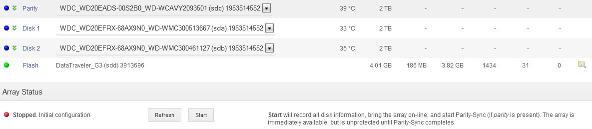

I needed a 16gb flash for work so I copied the entire \\ip-of-unraid\flash folder to my desktop. I then took a smaller flash drive, copied the unraid install to it and made bootable, then copied over all the /config directory. For some reason the disks are shown as new. I don't see much info in the /config/disk.cfg file, where is the array info stored? It has to be in flash somewhere!
Help - I really don't want to have to copy all this data somewhere, then rebuild, then copy back.. and I'm pretty sure if I assign the disks to the array now it will blow all my data!
There is no problem shown in your screen capture besides the loss of the configuration. Press start and then press the parity sync button if it shows up. The info is not indicating that the data disks will be formatted or anything like that so the 2 data disks should be fine.
thanks a lot! you saved me hours of unnecessary work. i owe you
