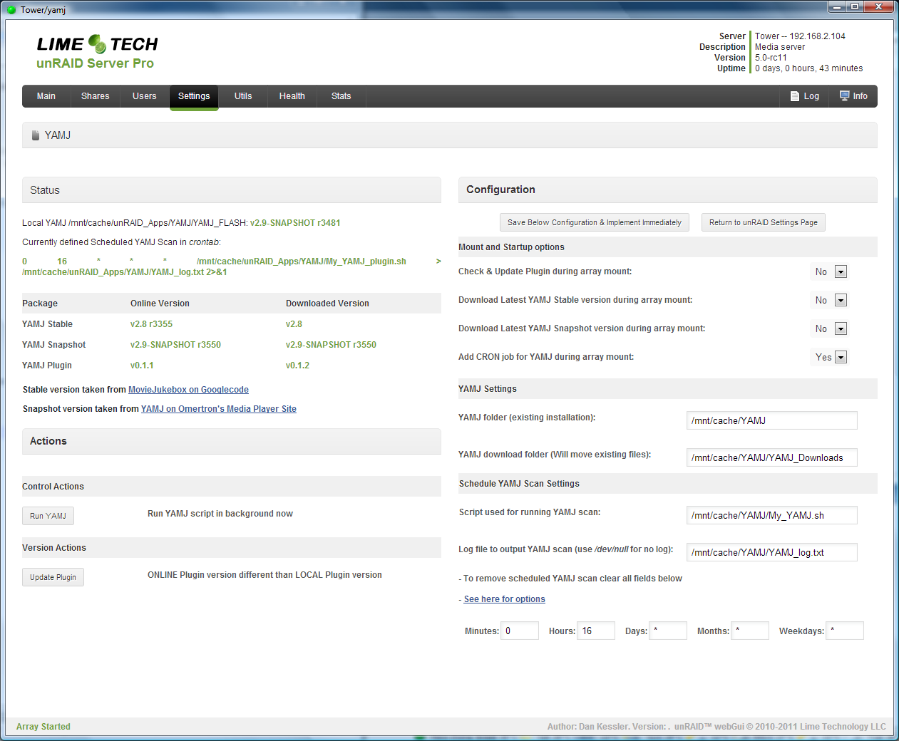

The WEBUI is divided into 3 parts:
1. Status Summary - Shows status of local and online YAMJ versions and plugin version.
2. Actions - Shows all possible actions available to the user depending on the status of the user's server.
  - Start YAMJ.
  - Download latest YAMJ versions.
  - Update plugin.
3. Configuration - Change settings of the plugin and YAMJ.
Configuration Notes:
1. Mount and Startup options - Change what happens during array mount.
2. YAMJ settings - Change location of existing YAMJ installation and download folder.
3. Scheduled YAMJ Scan settings - Change script and scan schedule times.

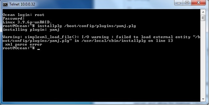

  I try to install but get this error.
