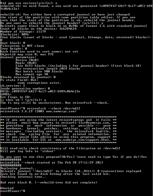

Ok after putting disk12 back in it completed it's thing and just got finished.  I ran reiserfsck --check /dev/md12 but it tells me that the reiserfs superblock cannot be found on /dev/md12.  Failed to open the filesystem.  It said that i should run this utility with --rebuild-sb.  So should I do this? Is this the correct command "reiserfsck --rebuild-sb /dev/md12"?
Yes, that would be the next step.  You need to let each reiserfsck guide you.
See here for the correct responses to its (--rebuild-sb ) prompts.  Remember to answer in exactly the same "case" as expected.
http://lime-technology.com/forum/index.php?topic=1483
Once it is done repeat the
and see what it next suggests.
ran --rebuild-sb and completed.  Then ran --check and got this error "Bad root block 0. (--rebuild-tree did not complete)".
OK, now looks like you can run
reiserfsck --rebuild-tree /dev/md12

it ran the check and completed.  Everything looking ok now,  Thanks a lot for the help.  I guess this is a good time to update unraid.  From what I can figure out from looking around.  All I have to do is download the newer version and copy the files from the zip to the flash drive.
