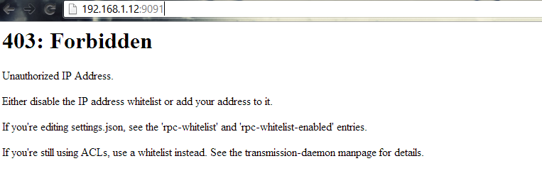

my screen capture are attached for your reference

Hi
Looking at the web page error it looks like you have put an ip address in the whitelist in "settings.json" that isn't the same as the machine trying to access transmissions web interface.
My rpc-whitelist and rpc-whitelist-enable
    "rpc-whitelist": "127.0.0.1",
    "rpc-whitelist-enabled": false,
My complete settings.json

Please bear in mind I'm still new to all this so i could be wrong, just an idea.
//serverIP:9091
