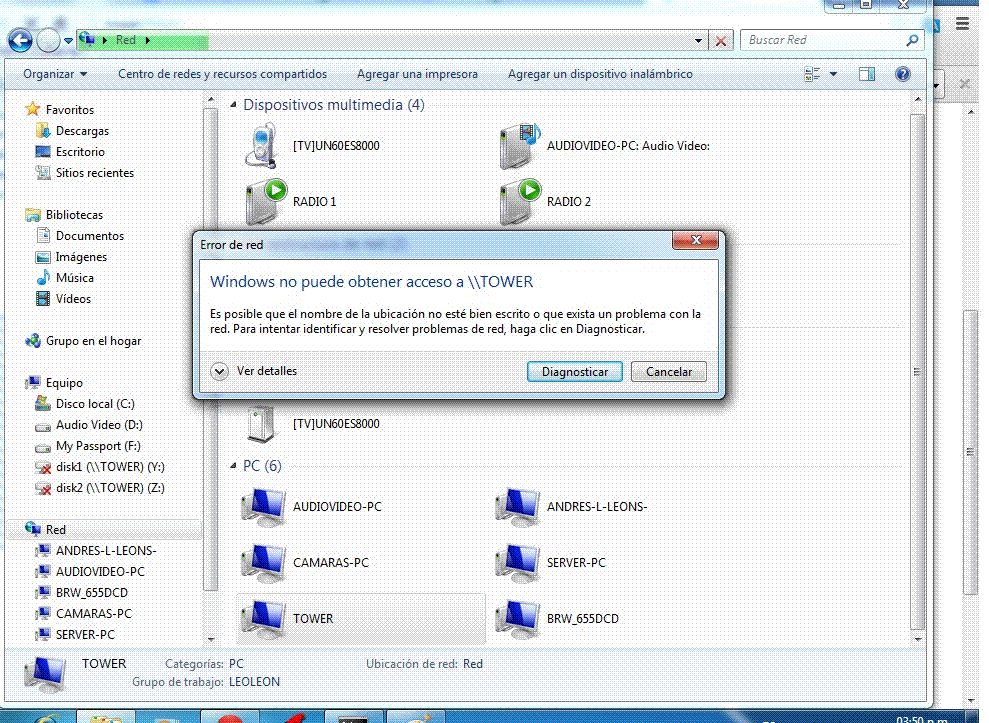

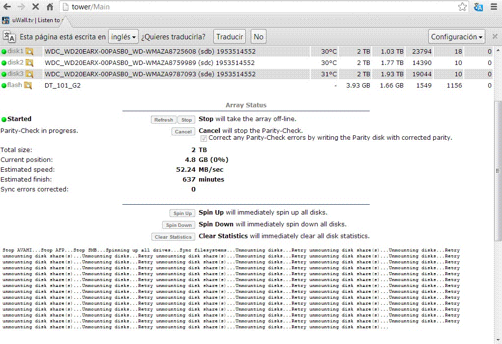

I was coping movies in unraid server using the Windows network. While they were copying the files I realized that these were not, and decided to cancel the copy. Since then unraid will not let me connect to the tower. When I try to go through any of the windows in my home computer says I could not access / / tower. But I have direct access to the tower using the browser. when I try to stop the Array tells me:
Unmonting Disk -Retry unmountin disk shares.Unmonting Disk -Retry unmountin disk shares.Unmonting Disk -Retry unmountin disk shares
Did you try to stop the array? You get the above issue (Unmounting/retry/etc) when you stop the array while a file is in use on the array.
Just never stops blocking the system and does not give me access, then restart necessarily need. And back to the previous problem
