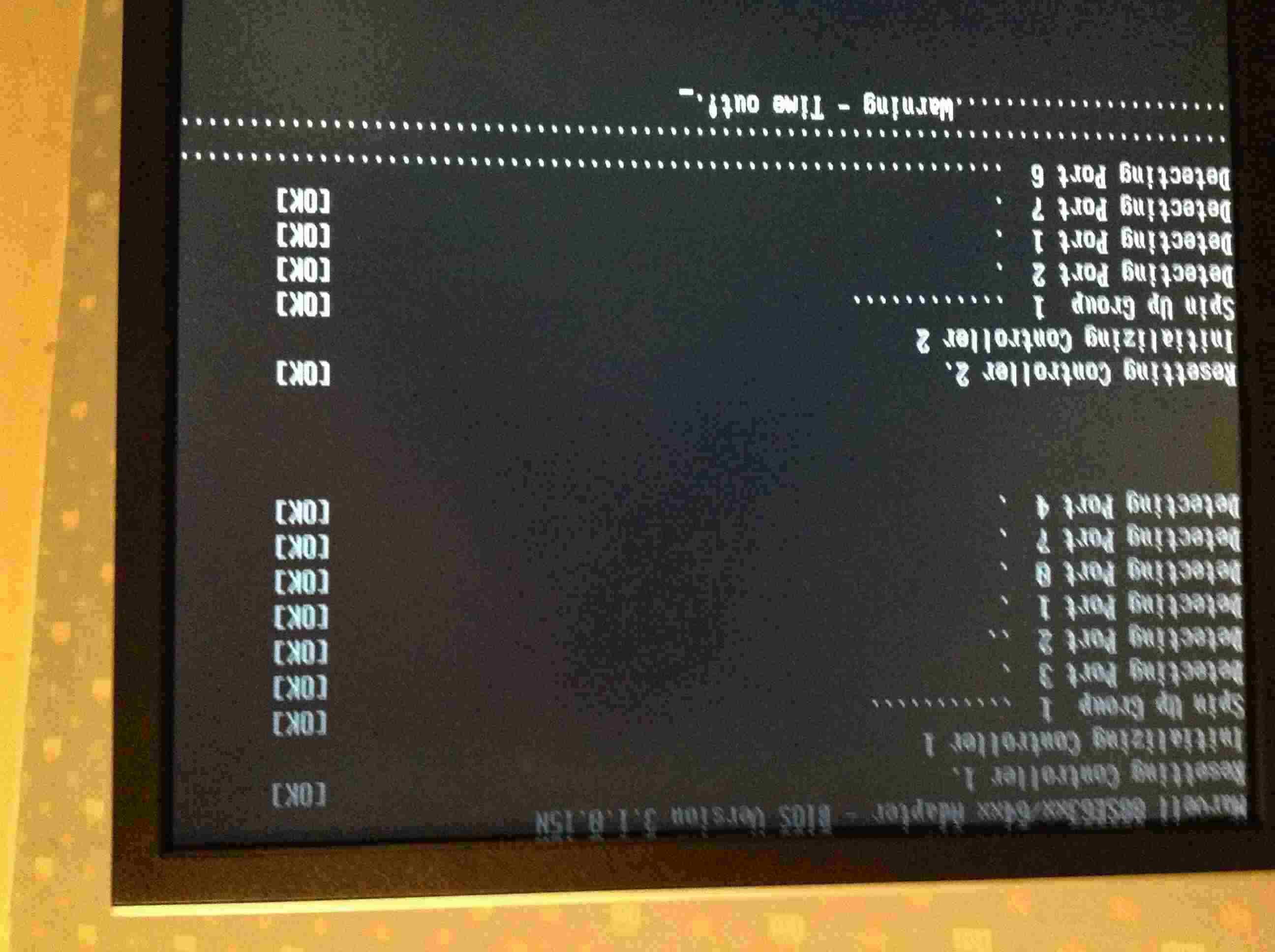

However, when I place the new 4 TB drive in a slot connected to one SAS connector on one card, the system hangs during the initialization process for that card.

I've been doing troubleshooting on this problem all day and I've narrowed things down without solving the problem.
To restate the problem: A 4 TB Seagate drive - the first drive larger than 2 TB on the system, hangs when connected to one "side" of an SASLP-MV8 card. During the posting process, when it gets to that drive it just hangs trying to deal with that drive until the routine times out and just stalls.  (see attached photo)
My system consists of Norco 4224 case with six controller boards each of which controls 4 drive bays. Connected to these Norco controllers I have 6 on-board SATA ports and two SASLP-MV8 controller cards one inserted into a PCI-E x4 slot and the other into  a PCI-E x16 slot. Each SASLP-MV8 has, of course, two SAS connectors which supports 4 SATA drives. It was one particular "path" - consisting of one connector on the SASLP-MV8 card in the x4 slot, an SAS cable, a NORCO controller board, and 4 drive bays that is probelmatic. The drive bays were easily eliminated since the system behaved the same regardless of which of four bays in a given row were used to house the 4 TB drive.
When the 4 TB disk was connected to an onboard SATA slot, either SAS connector on the card in the PCI-E x16 slot or the "good" side of the card in the x4 slot, unraid booted just fine and showed the drive as a new unformatted drive.
When placed in a slot connected to the other SAS connector on the card in the PCI-E x4 card the system wouldn't boot and wouldn't get past the posting process for the supermicro cards.
At that point all I knew was that one particular "path" wouldn't work. The culprit could have been the card, the cable or the controller card on the Norco case. There was also the question of the firmware on the cards (.15).
The first thing I tried was flipping the two SAS connectors on the card connected to the PCI-E x4 slot. This eliminated the controller card on the case, since the slots that wouldn't work moved to another controller board. This also eliminated the cable since the SAS cable were never removed from the Norco boards. Next I swapped the cards, putting the card that was in the x16 slot in the x4 slot and vice versa. The problem remained with the x4 slot, thus eliminating the card.
Next I tried updating the firmware to .21. After doing that the system wouldn't boot. It would say something about initializing RAID and hang. But curiously, with  the .21 firmware installed, the system had no problem recognizing the 4 TB drive in a slot where it had previously been unable to properly deal with the drive. It was after that point, where the system was getting confused regarding RAID that the system hung.
I tried to see if the .21 firmware had somehow changed some motherboard BIOS setting, but the system refused to allow me to get to the MB bios while booting. I had to disconnect all the SAS connectors from the Supermicro boards and physically remove one of the cards in order to investigate the MB bios (nothing had been changed) and to re-install the .15 firmware on the Supermicro card. Then I had to remove that card, replace it with the other and re-install the .15 firmware on the other card.
After re-installing the .15 firmware to both cards and re-attaching the SAS connectors to the Supermicro cards,  I could boot successfully to unraid and was back where I started. So what do I think I have learned?
-It is NOT the Supermicro card (Whichever card is in the x4 slot is the one that has the problem)
-It is NOT the Norco board (Swapping the SAS connectors on the card in the x4 slot moves the problem to a different Norco Board (and incidentally another SAS cable).
-It is not an INT 13 problem. (It has been disabled on both cards and the system shows no evidence of trying to boot from the 4 TB drive.)
- The system recognizes the 4 TB drive, wherever it is placed if I use the .21 firmware, but using the .21 firmware causes the system to hang thinking it is trying to load RAID.
It looks to me that this is basically some incompatibility between my motherboard (GIGABYTE GA-MA785G-UD3H) and the Supermicro .21 firmware.
