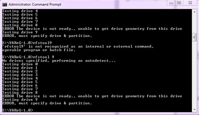

I want to try to mount disk9 to my other system directly to check.
Where can i find the right reiserfs for Windows 7 ?
Thanks... but why am i getting this error ?
Most probably for the same reason linux cannot read it in unraid: its broken..
broken ? Meaning HDD gone case ? data on this hdd gone ?
It seems fairly clear that disk9 has failed.

Actually, i am connecting the disk9 to a SATA/USB3 docking station with the USB3 connected to my computer that is trying to copy the data.
In the Windows disk management, i can see disk9 but unformated so i cannot access.
I will try this linux reader and see whether it can read the content.

Also, i still cannot see the content of disk9 using the linux reader. Am i using it wrongly or what ??

Also i again try to access the disk9 using linux reader... how do i access it ??
