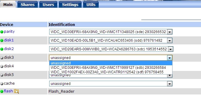

I recently bought my UNRAID license.
I installed a New 3TB drive
Which now made my configuration:
Parity = 3 TB WD RED
Disk 1 = 2 TB WD Green
Disk 2 = 1 TB WD Black
Disk 3 = 3TB WD RED (the new one)
All went well with the installation of the new disk.  I moved a whole load of stuff from an external drive to the UNRAID.
I went away on business,  and now have come back to find that the new 3TB drive dropped off the array.
It does not seem like it is a simple matter of just adding it back in...
Can you please lead this horse to water,  so that I don't lose my precious data.
Attached is a screenshot of my system as it stands.
Thanks.

that screen shot shows no evidence of a missing drive from the array.  All assigned drives are "green"
A syslog (before you reboot) is necessary for anyone to help figure out what happened.

Important!  Please act on item 1 ASAP!
1. You have the honor of opening a new chapter in the long and sad HPA saga!  You have a Gigabyte motherboard that is creating HPA's on your drives.  At this point, you have 3 drives with HPA's, one with the old-style Gigabyte HPA of 2113 sectors, and 2 with a new-style HPA of 8257 sectors, essentially 4 times as big.  Just going out on a limb, I'd guess that it is 4 times larger to hold a newer UEFI BIOS.  What is especially bad is that it now clobbers 4 times as many of your sectors as it used to!  2 of the drives have complaints about end of partition is not correct, meaning they have been clobbered and partition size was shrunk (Reiser file system may also be damaged).  I assume a parity check has already, or will show numerous errors at the very end of the check.  ASAP, reboot and go into your BIOS settings and disable the option to save a copy of the BIOS to disk!  I don't know for sure what it is called, others can help better there.  Off-topic tech note - I took at a look at the 2 HPA sector count numbers and noticed a relation, the older one appears to be 2K+65, the newer one appears to be 8K+65.
2. The syslog is telling a different story from what you believe happened.  It says that at 20:26:57, you added Disk 3, but when the screen refreshed at 20:27:20 (just half a minute later) Disk 3 was NOT assigned!  Somehow, you must have (probably accidentally) unassigned it.  Seconds later, you started the array, and it started exactly as it had been starting, with the original 2 data drives.  I know you probably don't want to believe that, but I believe I can help you confirm this.  There is no evidence of Disk 3 being formatted in the syslog.  *If* Disk 3 had been assigned, you would have seen a prompt to format (and possibly clear) Disk 3, and you would have seen a check box that had to be checked first before it would continue.  If your Disk 3 had been Precleared, then it would have taken a couple of minutes to format, and then the array would start and be ready shortly thereafter, with 3 data drives.  If the drive had not been Precleared, then it would have had to be cleared for several hours and the array would not start until that had completed, then it too would be formatted, and finally the array would start.  I'm hoping you can remember whether you saw a prompt to format Disk 3.  This explanation by the way is the only way that the pic you attached makes sense.  I suspect all the copying you did was to User Shares, and while you may believe it went to Disk 3, the files are probably on Disk 1 and Disk 2.

Thanks for the reply.  Would it help if I were to replace the board also.
Another question to clarify... does this mean that real damage has occurred to the hard drive that I can't get around ?
It's overkill, but certainly, because only Gigabyte has this HPA 'feature'.  They wanted to 'help' you, by providing another way to save a copy of the BIOS.  However, Gigabyte boards are very good, apart from this issue.  Changing motherboards is a lot of work.  All you should need to do is turn off that one feature in the BIOS, and then you'll have a good board.
No, not physical damage.  It just means that the Gigabyte BIOS on boot will save a copy of the current BIOS to the end of a chosen disk.  If it has'nt done that before to the disk it chooses, it automatically shrinks the partition, then creates an HPA region over the very last 2113 or 8257 sectors of the drive, then overwrites them with a copy of the BIOS.  You almost never have any files stored there, because that means you have completely filled the drive.  But the Reiser file system *may* have stuff there, and has its own idea where the end of the partition is, so may report an error in partition size.  The problem in UnRAID though is that the parity drive contains parity info for EVERY single bit of that drive, including the bits of those last sectors.  Since it has now been changed, parity is WRONG for all of those sectors, and if you had to rebuild *any* drive, they would be wrongly rebuilt for those sectors.  A correcting parity check will correct the parity info, but report numerous errors during the processing of those sectors.
