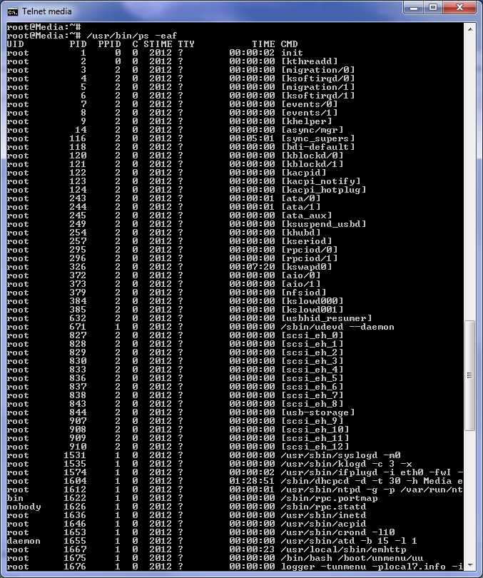

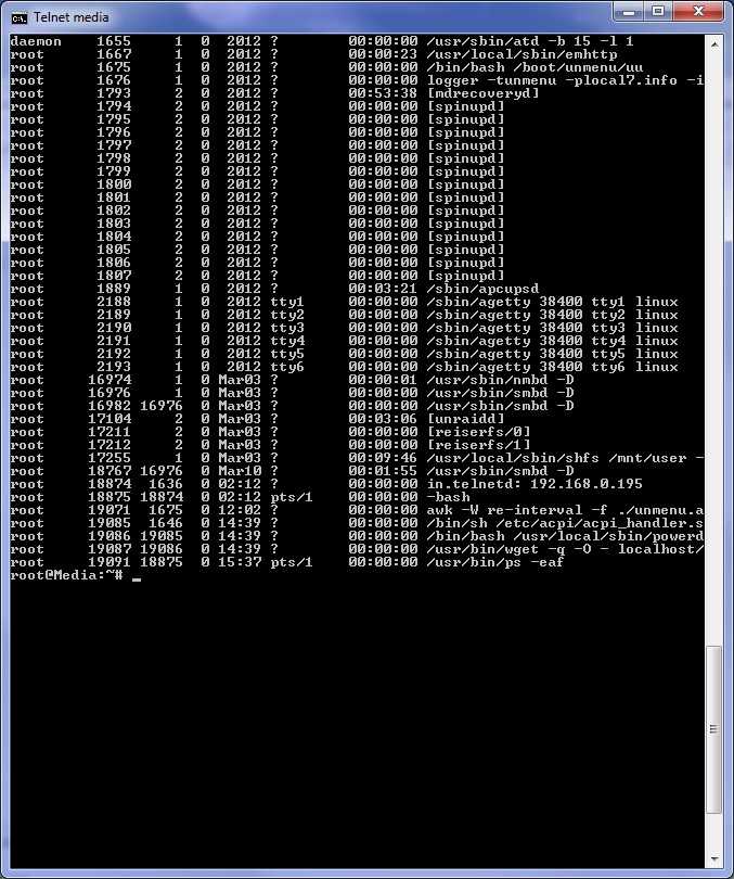

It takes two captures, but here's the output of /usr/bin/ps -eaf
It shows a line for both emhttp and unmenu/uu (see the top of the 2nd picture)  ==> does that mean they're both still running, but hung?
If so, how can I kill them and then restart them?

A few things I noticed on the list of processes ...
(a)  /usr/local/sbin/emhttp  => Does that mean it's running?  (but simply hung)
(b)  /bin/bash /boot/unmenu/uu  => Ditto for unmenu.    Also why the "/bin/bash" prefix?
©  logger -tunmenu -plocal17.info -i  ==> What does this mean?  Is it normal? or is it an indication of some issue with unmenu?
(d)  [mdrecoveryd]  => Does this mean something is trying to recover from an error?
(e)  /bin/bash /usr/local/sbin/powerdown  => Is this the powerdown I tried to run last night still trying to run?

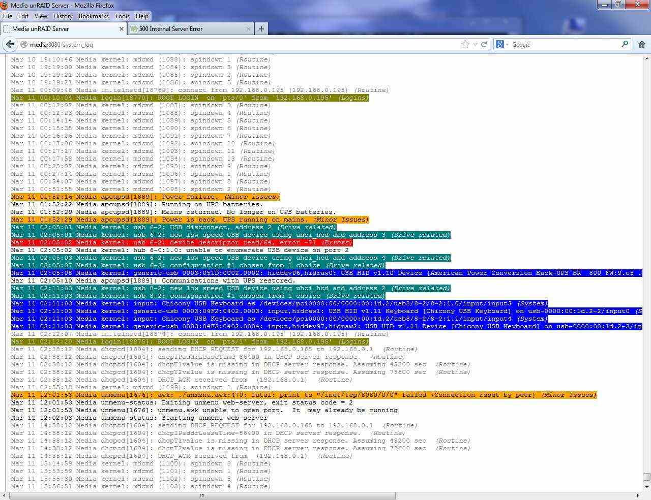

A bit more data ... while the flash drive doesn't have any recent logs;  UnMenu does show a complete log.  I've copied the most recent data -- attached below.
One issue not shown in this snippet is a line that read:
Mar  3 19:22:39 Media emhttp: shcmd (627): killall -HUP smbd (Minor Issues)
This is shown several times in the log --  on Dec 8, Dec 31, Jan 1, Jan 28, Feb 2, Feb 5, Feb 10, and finally on Mar 3 (the line I just copied).    Other than this line, and a few power failure/restore pairs when we've had minor power glitches that the UPS covered, there are no other "yellow" entries in the log -- and NO red entries except the one shown in the attached snippet, which I think is when I plugged in a keyboard last night (early this morning actually).
The attached snippet starts from when I logged in via Telnet, so this was after the web GUI stopped responding -- but there are NO non-routine entries in the log for days before that.    Note also the unmenu entries at 12:01:53 -- that seems to be where it "gave up" on connecting to the web server; and probably explains why I could then log in to unmenu a while ago.
