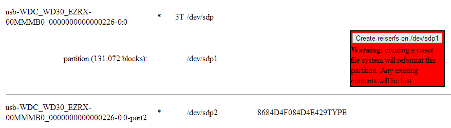

How mount 3TB USB drive?
Some seconds ago I tried to connect an 3TB USB drive to my RC11 box.
I tried the following commands:
mount -r -t ntfs /dev/sdp1 /mnt/usbdrive -o umask=111,dmask=000 -v
mount -r -t ntfs /dev/sdp2 /mnt/usbdrive -o umask=111,dmask=000 -v
Both return:
mount: wrong fs type, bad option, bad superblock on /dev/sdp1,
       missing codepage or helper program, or other error
       In some cases useful info is found in syslog - try
       dmesg | tail  or so
Syslog shows:
Mar 13 07:31:06 Tower2 kernel: NTFS-fs error (device sdp2): parse_ntfs_boot_sector(): Volume size (2TiB) is too large for this architecture.  Maximum supported is 2TiB.  Sorry.
Mar 13 07:31:06 Tower2 kernel: NTFS-fs error (device sdp2): ntfs_fill_super(): Unsupported NTFS filesystem.
I thought support for 3TB drives is build-in.
Thanks.
Harald
