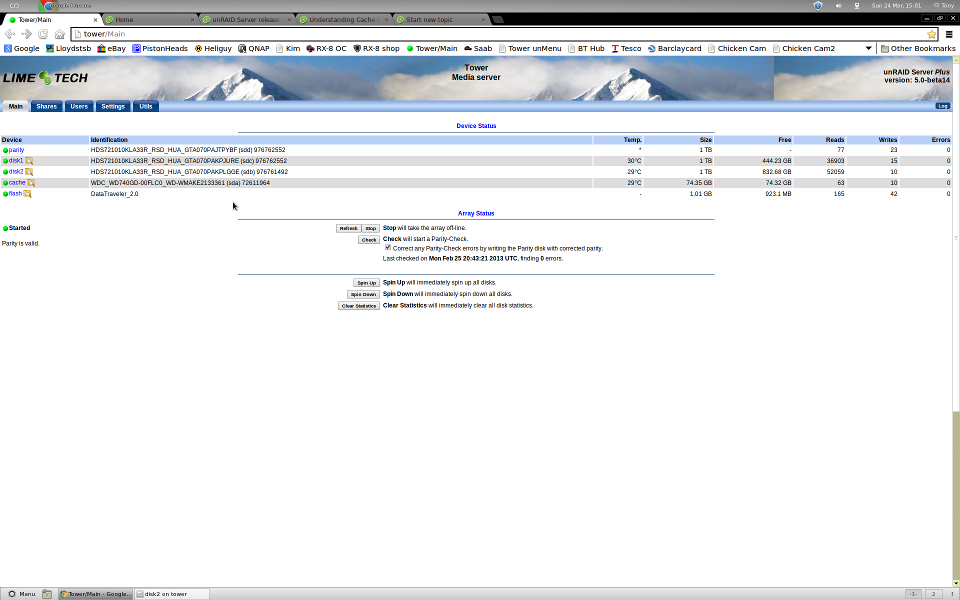

Hope someone can help. I setup an Unraid server trial using 2 data and one parity disk. I loved the stability but not the transfer speed so upgraded and added an 80GB cache drive. I stopped the array, added the drive, restarted and assigned the new drive to the cache slot and then formatted it. Speed tests showed no difference so I changed the min free space in share settings to 70000000(70GB) but then all my shares disappeared. The shares were OK after upgrading. If I re-create the shares nothing shows when I browse to it. The data is all still there if I browse to Disk1, Disk2. The top level Data share had a red ball against it but the pictures2 share was green when I recreated them but both showed no data. I did not preclear the cache disk first, assumed formatting would be enough. Layout is thus:

I did change the share settings to use the cache before testing, sorry didn't put that in the OP. It was when I changed the min free space in the share settings tab that I lost my shares.
syslog attached. I can see that I have HPA errors which I need to sort but surely this wouldn't cause this.

Where I am now is that if I create and export shares with the same name as the top level directories they appear in the browse list but when I open them no data is showing but if I browse to Disk1 or Disk2 I can see the data OK. Any ideas?
Another thing, when I now create a new share I can browse to it but can't add any data even though it is exported, uses both disks etc. copies fail saying no data.
