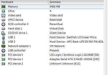

I have sucefully installed and running ESXi on this MB -> http://www.asrock.com/mb/Intel/Z77%20Pro4-M/?cat=Specifications
Successfully passthrough my PCIe card....
  • ServeRAID-BR10i
  • Adaptec 1430SA
  • 2 internal SATA3 6.0 Gb/s ASMedia ASM1061  connectors
Thanks to all who contribute ESXi knowledge and experience in this forum.
