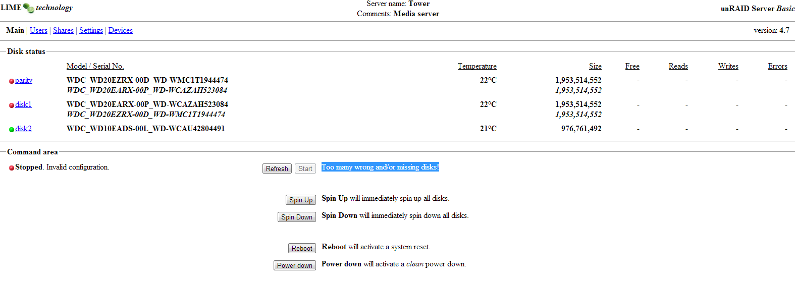

thanks for your quick reply.
When I follow the wiki, /dev/md1 is not found.
The gui shows an invalid configuration (Too many wrong and/or missing disks!), it seems like it replaced disk1 and the parity disk.
Disk2 is green.
Should i run initconfig ?
Disk2 is green.

disks atm are not reported as unformatted anymore (see attached image), but it appears as if it has swapped parity and disk 1.

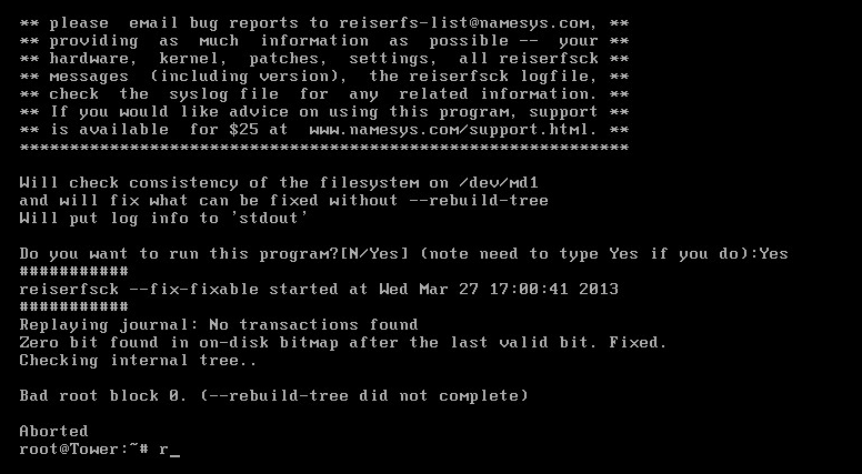

md2 reiserfs says it can't find the superblock

Ok. So I'll do a --rebuild-sb on the 2 2TB disks.
How do I get rid of the invalid configuration, because I need to have /dev/mdX available.
I presume the array has to be down
You'll need to set a new initial configuration to bring the array online so /dev/md1 and /dev/md2 are available.
Just do not connect the third disk as of yet.  You can then try recovering data from both disks by rebuilding the superblock on both.  One will do better (hopefully)

Both disks still have issues, but I expected that.
I would now try
reiserfsck --fix-fixable /dev/md1
and
reiserfsck --fix-fixable /dev/md2
Edit: fixed typo
I attached the screenshot and syslog
and the syslog and md2 log
syslog.txt
They both need the same rebuild of their internal file-tree.
reiserfsck --rebuild-tree /dev/md1
reiserfsck --rebuild-tree /dev/md2
This step may take a while if the disk was full.
Joe L.
