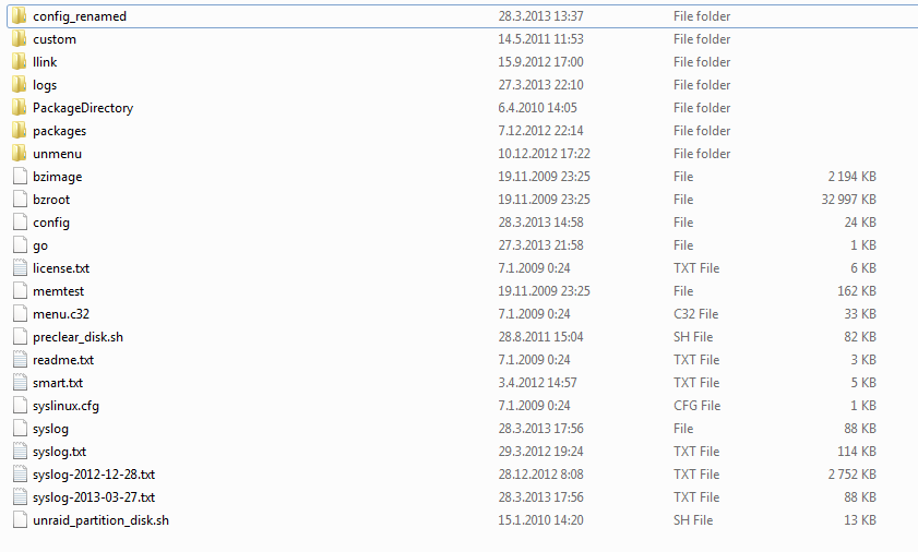

I tried to rename the config_renamed back to config when I noticed my mistake, but it did not let me because there was already file named like that. Then I just thought that I just delete the config file (that had no extension) and change the config_renamed manually to config. Then booted. Seemed to work fine for a moment....
The reason you could not rename 'config_rename' directory to 'config' is because you NOW have a file called 'config' in the root of your flash drive.
You should probably shut your server down, pull the flash dive and use a Windows/Mac computer to fix it.  (I have no idea how that file got there.  It has a very recent date stamp on it though.  For safety sake, you might want to rename it rather than deleting it.)

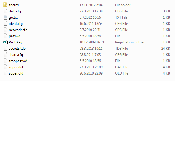

Your unRAID "key" file is in the config folder(Directory) and that is why you can only see three drives.
Then rename those directories inside of  the config folder (renamed from 'config_rename') that JoeL told you to.  I would also rename that 'PackageDirectory' folder that is the root of your flash drive.
I now renamed the config file to config_renamed and attached are the inside of my config folder.
I do not have the folders Joe suggested.
Wow.... this works now.
I renamed all of the folders that seemed to be for somekind of addon or a plugin.
