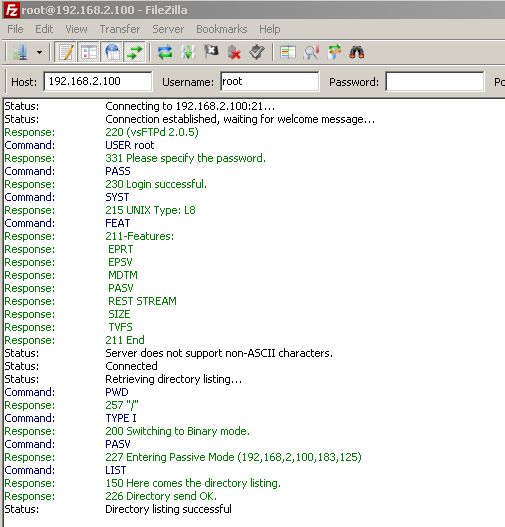

Works here using filezilla, and I've set nothing up for ftp previously.
The supplied vsftpd.conf file looks like this:

Joe L,
My vsftpd.conf file at /etc matches exactly with you....Only difference that i can see is for your filezilla log msg it says "Please specify the password" whereas in my log it says "Response: 530 Permission denied."
Have you done anything different in your filezilla client or do you type any password in filezilla ??
Joe L,
I do not have a root password, and type nothing.
I notice both look for valid users in /boot/config/vsftpd.user_list
Do you have that file?  (I do, and it is completely empty, but it seemed to work even without it after I deleted it )
I'd then say it is a permission issue on your server.

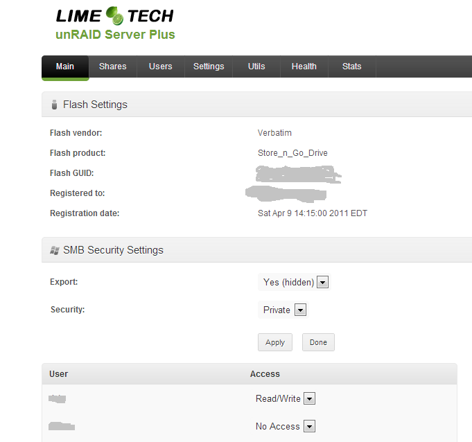

This has nothing to do with getting your FTP working, but...
Why don't you just share your flash drive? I never take mine out to add/update plugins or other addons or even upgrade unRAID versions. Click on the flash drive from the main page and you can share it like so:
I Can share my USB/Flash Drive and that's what I am doing so far....But my basic question remain answered...Why does the FTP is not working on my server whereas everything else pretty much seem to be working.
