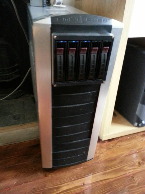

Hi everyone, I have a coolermaster 810 stacker, and just started swapping the bays that came with the case with 5 in 3 sold by xcase, which I believe are rebadged Norco ss500.
All good, led work and install is a doodle, apart from one small problem: they won't go all in, currently sticking out about 3 cm from the case.
What am I doing wrong? Do I really have to start hammering the case? Not a good thing to do when you have 13 drives in the case.

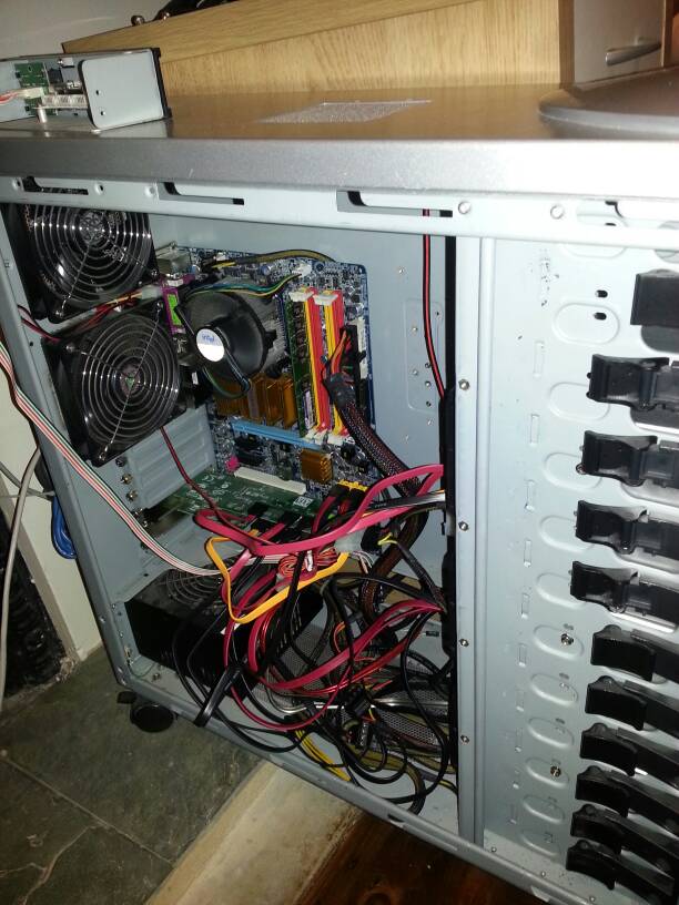

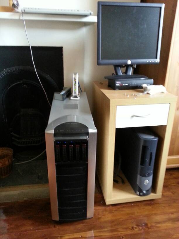

A few pics of my unraid server

Can you see what's blocking it inside?  On some cases there are tabs you have to either bend down or break off to get the cage to slide in all the way.

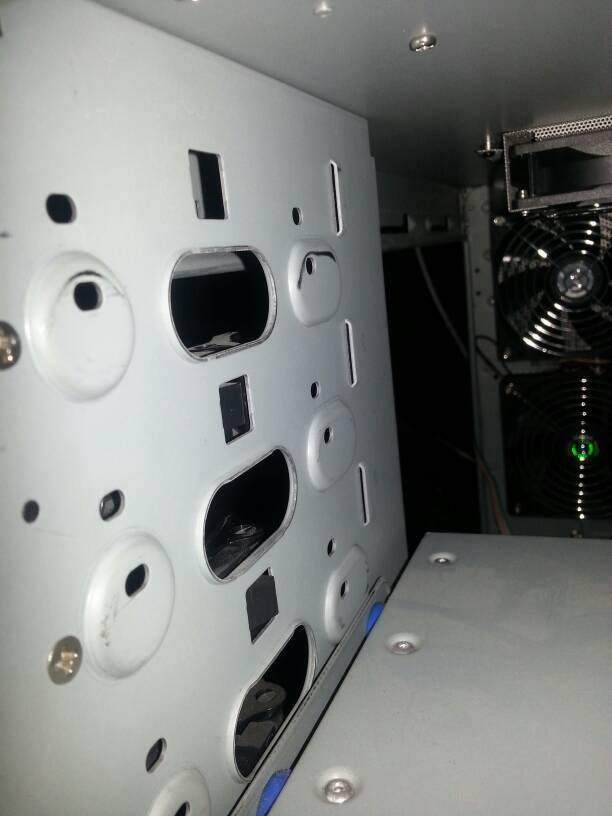

Not sure. The case is full right now, have just ordered another two 5 in three caddies, so I can remove all of the drives and take a good look at it. I suspect I'll have to buy some diy tool that I can use to push those bumps is without hammering the case.

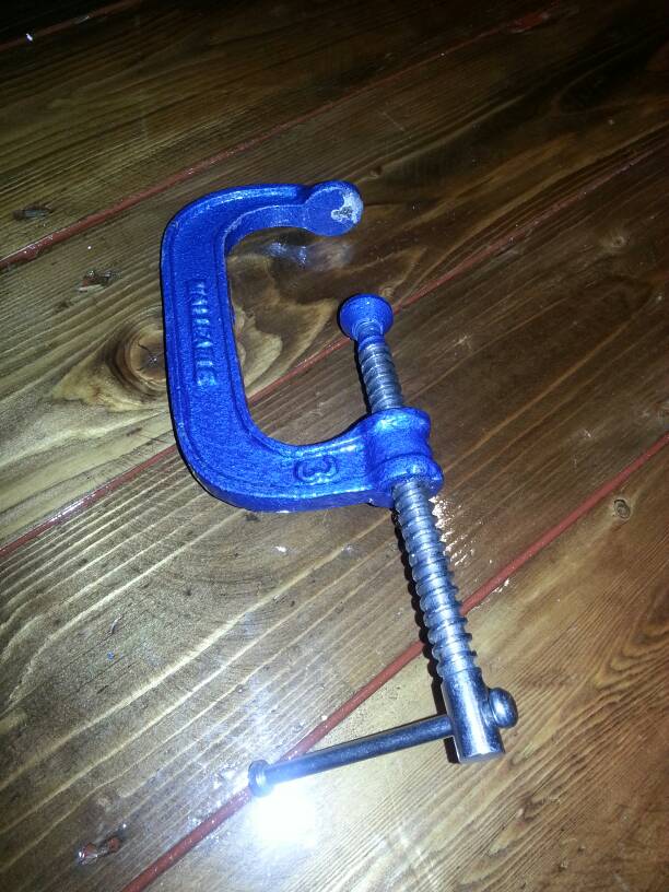

Maybe a screw clamp to push them in?

I can't see the bumps in the pictures you provided, so I guess I can't offer any suggestions on how to get rid of them that would be particularly helpful.

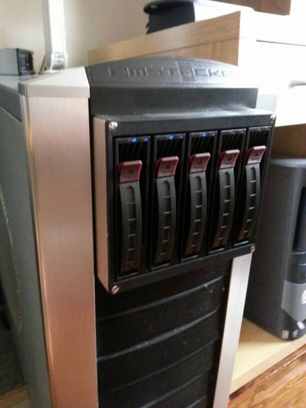

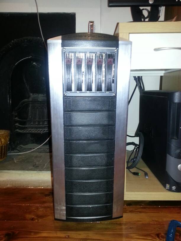

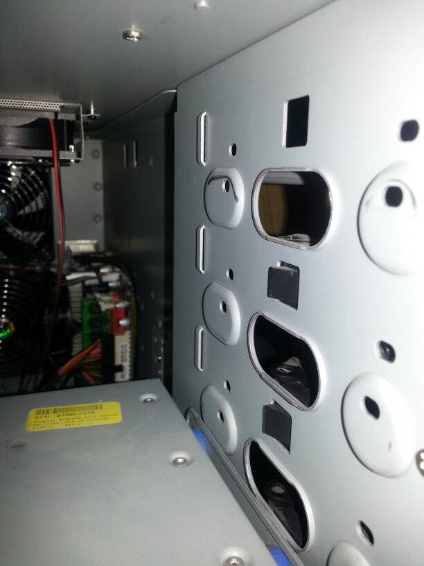

Mystery solved. The vertical metal grooves at the back of picture one and two were stopping the caddy from going all in. Once I pressed them in, the caddy went in all the way. Job done. I should receive the other two caddies tomorrow, will complete the transfer on the weekend.

Caddy in position

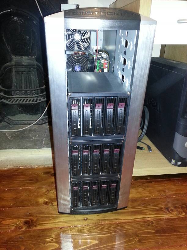

I actually installed two more caddies yesterday night.
Swapping 14 drives took some time, I also labelled all the sata cables...
Amazingly it all worked out straight away!

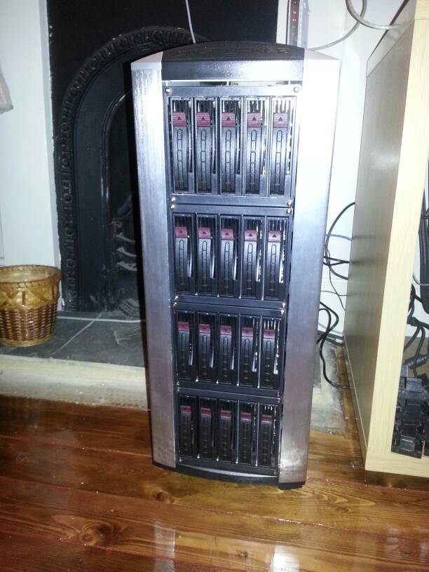

A few pics... the alignment of the screw holes forced me too keep the caddies as they are in terms of orientation.
One thing I noticed is that the disks are getting a little hotter. Temps of the old 500 gigs Seagate are just around 40c for those sandwiched in between. Temps of the ones on the outer ends are slightly lower.

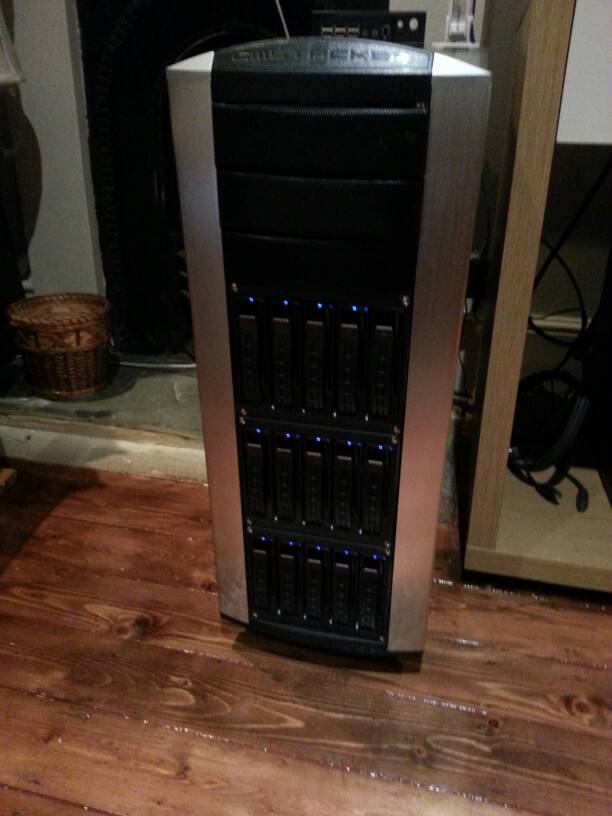

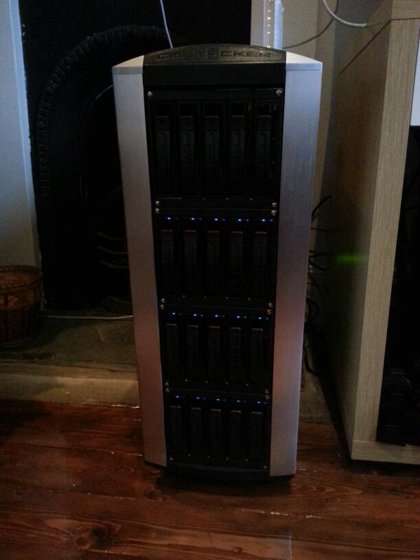

Case complete

SWEET. That's how my server looked, only I used the supermicro 5x3.
